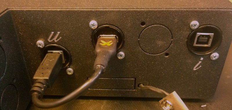

The thing that puzzles me though, is how PE and signal ground are connected and why the Phisolator seems like a player in connecting the two.
Anthony, to start with the latter bquestion, this is not so at all. But it seems clear to me that when the former happens, there's too much of current on the Phisolator. And in an attempt to answer the former question :
I too need sitting back in figuring out how this happens. But say it is too complicated to follow all. Some intruduction though :
That black wire (connected when Sw#3 is down for the NOS1a and permanently connected for the normal NOS1) crosses a "surface" in the DAC case, say diagonally from the USB input to the other end (somehere under the main power supply). This is to guide away radiation and what it does is bring the USB shield to that other end.
OK ...
What I next found was that the Phisolator "just" requires this connection to be differently, additionally. I know I won't be able to explain it and it was all empirically found but where the normal USB input is connected to this black wire, the Phisolator's input goes *via* this same original input and ...
Needs is own connection to the case, but this time close by.
USB's shield is now connected two times to the DAC's case - one time right at the position of the input terminal (see photo below at the "i") and one time when it again enters the case via the normal input terminal (this goes via what I call a loop-back wire - see at the "u") but then via this input terminal shield across the DAC as always. Each can be connected and this connected and the permutation of 4, each give different results on the amount of errors - hence, this all has such a strong impact that the active part of the isolation fails, or just works fine.
While the above only explains about the internals of the NOS1a with Phisolator (SUB Isiolator) inside (and the "a" part being that other galvanic isolation further downstream), things probably get bananas when that black wire hence case connects to signal ground (which I would not like in the first place) but which is realized by my analyser but maybe is normal. Look :
My NOS1a/G3 what this is about, is not connected to PE, but of course the normal power cord is. It is only that where it enters the extension block, the PE is cut in that block.
BUT
These are copper strips and all I did with this block is cut that strip right in the middle of the 10 outlets it carries. Thus I now have 5 connected to PE and 5 are not. But think carefully, because that one half which is not connected to PE *is* connected to each other. Thus when I put the power cord from the NOS1a in there and the anayser in that same groupf of 5 (which I do), I have the cases of the two connected, well, assumed that the case of the analyser is connected to PE but which I did not check.
It would not be the first time that a device connects its dignal ground to PE and how knows the analyser requires it (it is a device to measure precisely, and I actually have not much knowledge about what's best for such a device). Anyway, if it connects its PE to dignal ground, then via its inputs the signal ground goes into the NOS1a and ... bingo. Now PE is connected to signal ground from the perspective of the NOS1a.
Anyone who uses a preamp or amp that connects its signal ground to PE *and* who does similar to what I do with my extension block or who just cut the PE connection from the NOS1a's case, ends up with the same situation and the Sw#3 should be up or otherwise this connection from signal ground to PE from the perspective of the NOS1a, is a fact.
In my own situation I measured that Sw#3 must be DOWN. If I don't do that, I might have USB errors. This is also the situation (since Phisolator) that I again connected the PC to PE, including the PE Switch on it set to "On" (connect to PE indeed). Do notice that I measure this with radiation meters, which I obtained after our conversation about them, many months ago by now. So it is quite easy to see, but it is not said that more radiation imply more errors. It could be that the radiation shows that "noise" is guided away through air, God knows what the receptor it.
Dizzy ?
Then let me again add that with this Terradak situation, both NOS1a/G3 as well as PC/Terradak must be in mains earth or otherwise really nothing works (1000s of errors per second) and that this time Sw#3 must UP or again otherwise totally nothing works. But it doesn't work well anyway, because still too many errors (like 3000 in 10 minutes).
And oh, notice that the determinatin of this single little chapter of working out these permutations, cost one afternoon. And then you end up with nothing (no satisfactory result).
Now on to the Silverstone (OK, almost) ...
