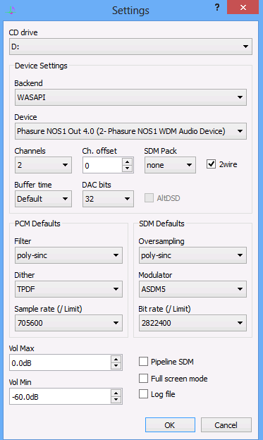

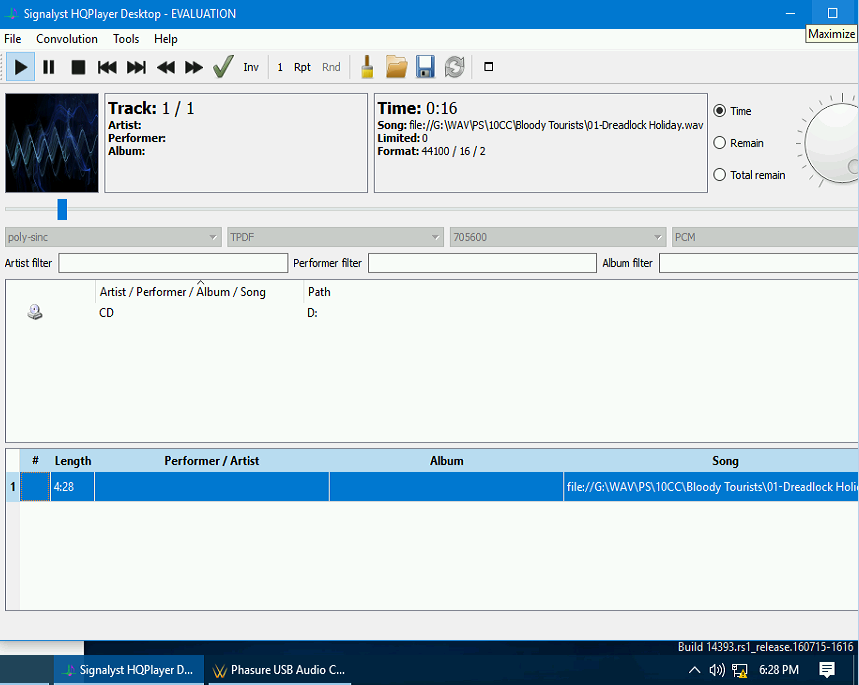

And *again* I have been strugging for an hour to get something out of HQP. At least from W8 but maybe with the knowledge I obtained there, also from 10586.0 (must see about that later).
In general, this is how it works :
You set the "Sample Rate (/Limit)" to what you want to play or upsample to. As far as I can tell this must be equal to what the Driver is currently set to. And this is the caveat (again,as far as I can see) : HQP does not dictate anything to the Driver for Sample Rate setting - it absorbs instead and next it must match.
When you did these both you MUST reload whatever track in the Playlist because the former one (possibly still there) is connected to its (!) set sample rate and things will never work any more.
A next thing to guess (nothing explicitly in the manual about that, but in the end I figured it out) is that with Dual Wire the Sample Rate in the driver MUST be half of what is set in HQP itself. Thus, set 352800 in there, load a track which next will also show the 352800 in the haeder with the chosen filter, dither means and codec (like PCM). So now things again "match" which remains the prerequisite.
Side note : this ratio is nothing different from XXHighEnd but this works the other way around (the source dictates) and this thus always works (as long as the DAC can accept the output (of the player) Sample Rate.
Also notice that with Dual Wire, 4 channels are expected (as in "Dual Stereo"), thus set the Driver to that (output). But also select the 4.0 Driver in HQP under "Device").
Knowing all this, and especially knowthing that this all works like this, it only takes one step further for 705600 : add that one step everywhere. Thus, set the driver to 352800 (was 176400), set HQP to 750600 in Sample Rate (/Limit), reload the same track and ... it does NOT work.
What I see with Dual Wire, is that somehow now surely the Sample Rate of the Driver is cut in half. Thus, driver can get that command after all and something special possibly is happening. But when that happens, HQP always hangs and must be killed. This is when I go lower with the Sample Rate; When I go higher, again the Sample Rate in the Driver is properly set, but this time just nothing happens for playback but nothing hangs and we can press stop.
I suppose that what is happening here, is that possibly too soon the set Sample Rate is received because it takes maybe 100-200ms to set it (this happens in the DAC). And yes, WTF ! I now notice that if in this latter situation I press Play one more time, it just works (and I recall that now). And you know what ? loaded with this crazy data I got the 705600 running as well.
Mind you, Windows 8 this time (and 100 minutes or so further AGAIN).

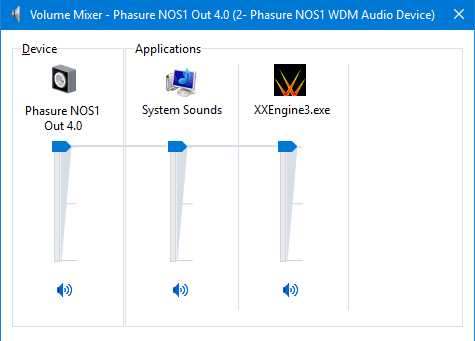

ALWAYS KILL XXENGINE3.EXE prior to a next playback attempt. This is due to a bug in XXHighEnd which disallows to change the Sound Device from withing the these days always running XXEgnine3.exe.
I will just put all in the sequence I experienced it myself.
Today I started out with W10 10074 in the hope that nothing had changed much regarding the transition from W8/W8.1 to W10. So, I learned that things had changed in WASAPI, and thought that this could be the culprit (something not compatible any more, which could count for XXHighEnd but just the same for HQP.
Thus this is for W10 10074 :

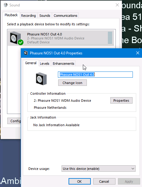

You may notice the flashing loudspeaker icon in the Taskbar Tray (people reported this (ever changign sample rate) in the past indeed, and I recall that "one time playing" solved that flashing).

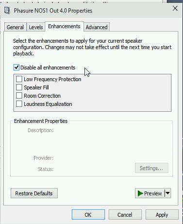

Switch off all Enhancements in Sound Device Properties - Enhancement tab.
(later we will see that this is key to all)
Select KS in XXHighEnd and play a little. This stops the flashing, and gives the ability to change other things while being in "WASAPI mode" (otherwise the ever changing locks you out from applying different settings).
Do notice that I am first attempting to let XXHighEnd work with WASAPI under W10 (and sure not the ever so (for me) vague HQP incarnation of it).
Select WDM in XXHighEnd and play a little.
Loudspeaker icon in Taskbar Tray now does not flash and all is fine. We can play with the WDM (WASAPI) device with just these settings (but they are not crucial Happy
One caveat : Afer a reboot we again must first play a little in KS and repeat the procedure. I dedicate this to W10074.

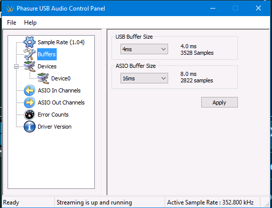

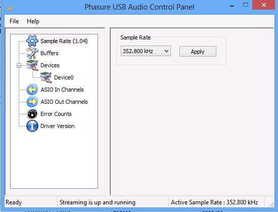

In 10586.0 HQP plays up to 352800 (352800 in HQP settings and 176400 in Driver Control Panel). Notice that this is with 2Wire.
XXHighEnd is fine with 705600.
In 10586.0 HQP *only* plays with mentioned 352800. Not higher but also nothing lower. To me it seems that this is stuck in the missing tab (Driver Properties - Enhanced). So the main thing occurring opposed to W8 is that HQP will not change the Sample Rate as we see it in the Driver Control Panel (I did not test this with 10074).

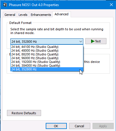

When the Driver is reinstalled, the Advanced Tab comes back; what we can see in there is that only sample rates 24/44.1, 24/48, 24/88.2, 24/96, 24/192 and 24/384 are supported for Shared Mode. 24/384 is (found to be) selected.
When we play a little with the KS: driver, the Advanced tab disappears.
Playback Attempt gives an "Invalidarg" error message.
After this re-install of the driver it appeared that I forgot to disable all Enhancements, and when I did that, the advanced tab reappeared. Also, there's now 24/382.8 visible, but in a strange fashion.
I now selected this 24/352.8 in the Advanced Tab.
HQP now works.
(later I found that this step of selecting this 24/352.8 most probably is unrelated)
I set the Driver Control Panel to 384, set HQP to 768, selected a 24/96 and that works as well.
Maybe this can go with less manipulation, but at least this all works.
I rebooted 10586.0, started with a 16/44.1 which played right away. However, I abusively let HQP be at 768 and so it played with 768 output.
In the hope not to destroy things, I changed the Driver Control Panel to 352.8, changed HQP to 705.6 and all still worked.

I again disabled all the Enhancements.
I set HQP to 705.6 (2 wire), Driver Control Panel to 352.8, loaded a 16/44.1 and ... that now too works in one go, while before I was dead sure that especially 14393.0 couldn't do a thing with this (and WASAPI in general).
Conclusion : Because of a totally stupid W10 quirk nothing works. But find that quirk and you won't notice a thing of "nothing works". I am again 4 hours further.
