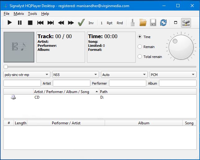

« Reply #59 on: August 07, 2017, 07:11:54 pm »

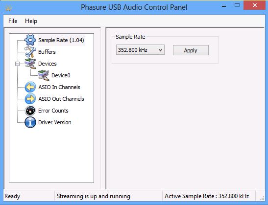

I've had a couple of PMs recently asking me to just go through the steps in getting the Roon -> HQPlayer -> NOS1 path working correctly. Most of the important steps have already been spelled out in Peter's earlier posts in this thread, but I thought I'd put it all together.
1. Make sure you are in Normal OS!
2. Install Phasure driver (I use 1.04).

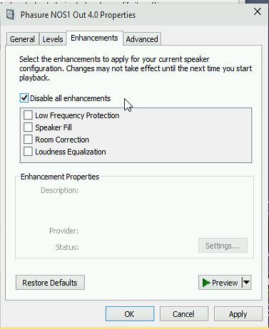

3. Go into Windows Sound Properties and make sure 'Disable all enhancements' is ticked [Peter discovered that this is the key to getting this all to work].

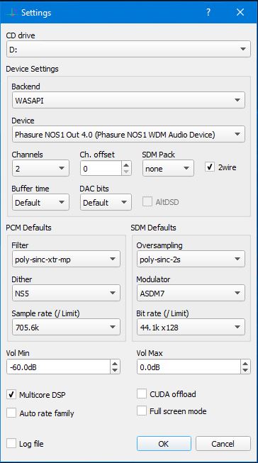

4. In HQPlayer Settings, select Phasure NOS1 Out 4.0 as Device
5. Make sure '2wire' is ticked [the NOS1 is probably the only DAC that can actually use this in PCM!]
6. Peter found that the correct sample rate needs to be selected in the Phasure Control Panel. (The rate shown in the Control Panel will be 1/2 the rate that will actually be sent to the NOS1 - don't worry about this, that's what the '2wire' is all about.) Ordinarily, XXHighEnd will do all this automatically, but HQPlayer doesn't seem to be able to do this. So we need to do it manually. What I recommend is simply selecting 384kHz first, and then selecting 352.8kHz back again - to force the Control Panel to the rate we want.

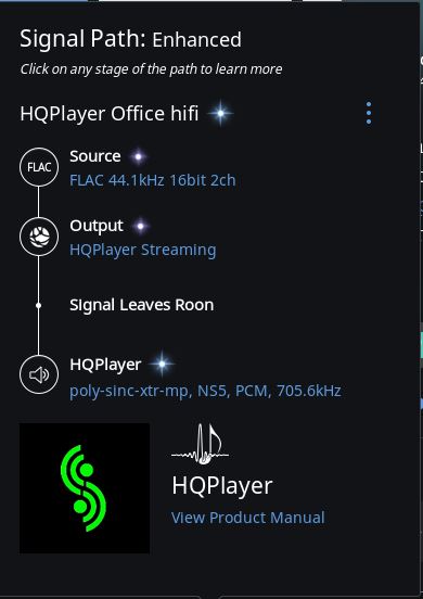

7. Probably best to test that everything is working locally at this point. But ultimately, you want to use Roon remotely. To do this, firstly ensure the 'network' icon is selected on the HQP Desktop.

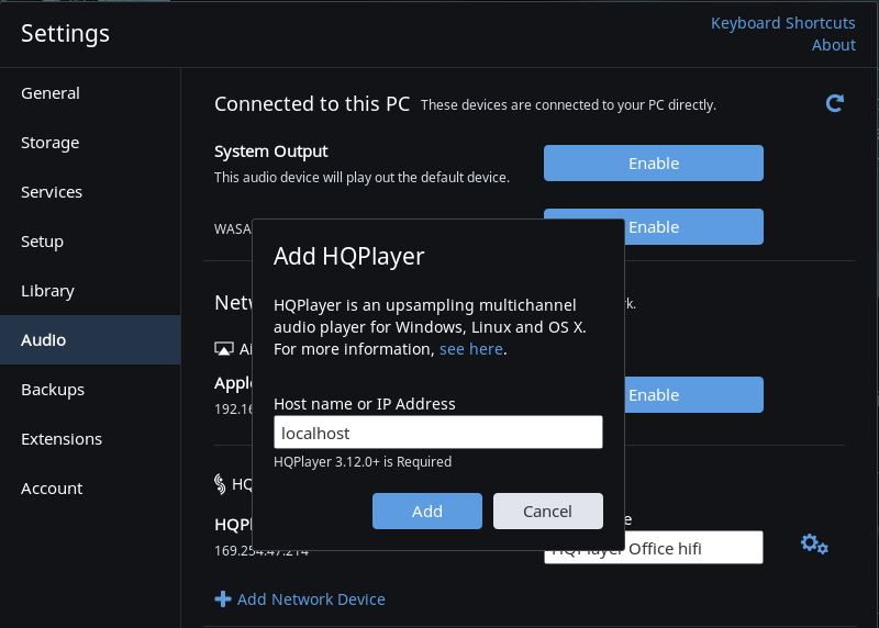

8. In Roon, add HQPlayer. Simply put in the IP address where HQP sits.
9. Test that everything is working correctly!

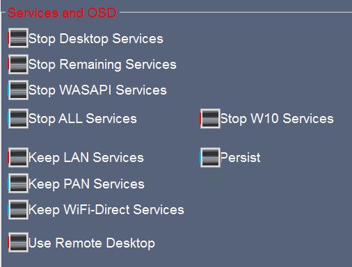

10. Everything will work in MinOS mode and RAM-OS, but make sure you have 'Stop WASAPI' disengaged in XXHighEnd before going into MinOS.
11. Sit back and enjoy the second best sound you can achieve from a NOS1  Wink
