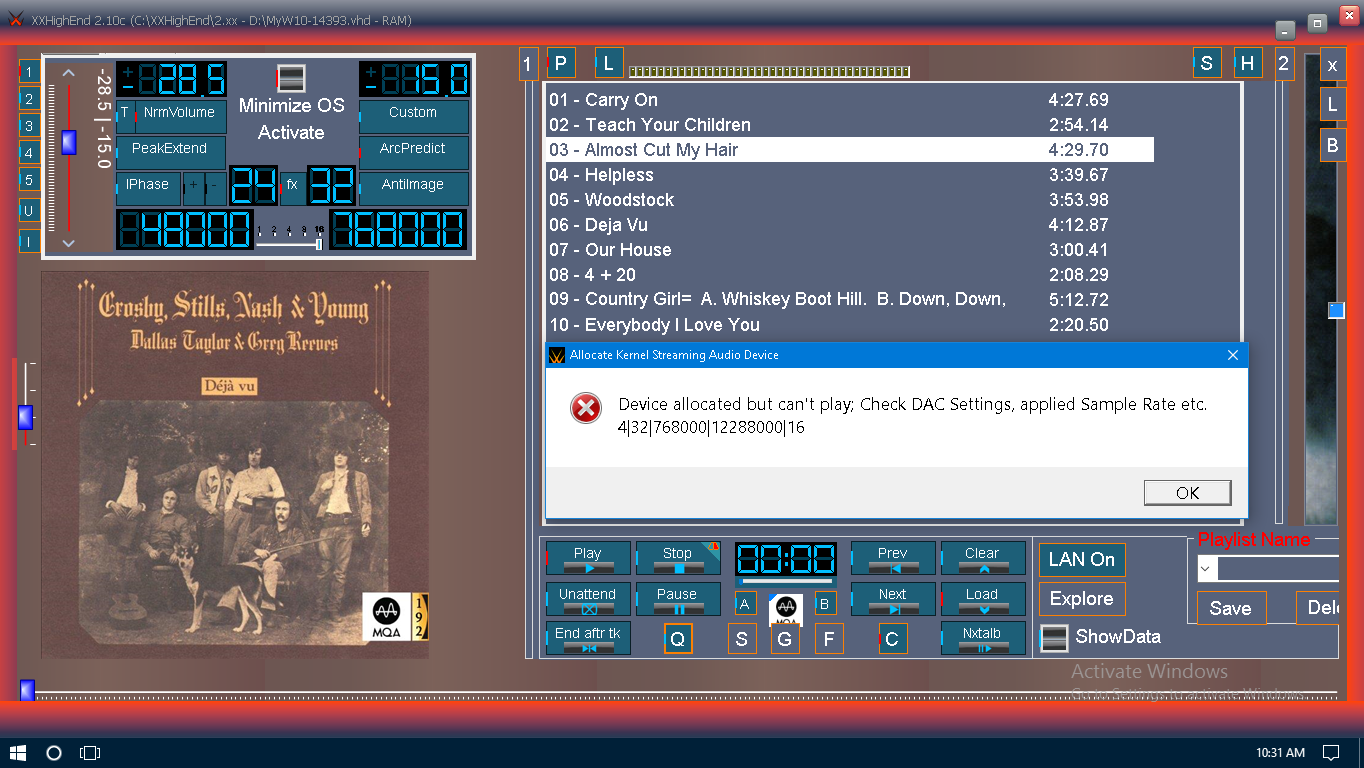

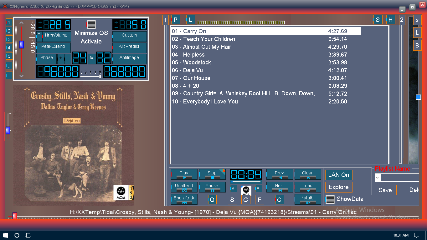

I came across a strange problem while playing CSNY\Deja Vu MQA 192 from Tidal.
The first 2 tracks played normal. The third track the speed reduced significantly. I tried playing the tracks again, the first 2 tracks showed input sampling freq of 96, however the third track showed 48, which probably explains the reduced speed. However this time the third track didn't play (even at the lower speed) instead a msg popped up.
I am attaching 2 images for your ref.

« Reply #109 on: April 10, 2018, 09:33:39 am »
Hi Arvind,
I will check that album, but do notice that it exists that tracks of an MQA album can be non-MQA. I'd say for a normal artist (like CSN&Y) album this is rare but for collections or Playlists this can easily happen for sure.
What I am not sure about at all, is whether XXHighEnd still deals with this properly. So Zheng already reported a "too slow speed", and now you do too, while I never experienced that (and it shouldn't be). Small problem : all my albums have been prepared with the decoder active at the Music Server (Tidal) PC and such a thing can only (?) go wrong with new Preps. Anyway, I will do so with Deja Vu and let you know (later today, if I don't forget).

Hi Arvind & Peter,
Out of curiosity I downloaded this album and played each track. I found no issues at all--all played with a 96 on input and MQA logo on with blue corner. Now I'm playing entire album unattended, it's still going strong. A delete and re-download might fix the problem for Arvind.

« Reply #111 on: April 11, 2018, 08:55:06 am »
Hi Peter & Zheng,
Re preparing the stream seems to be the next best thing to do. I’m sure this should sort out the issue in this album.
