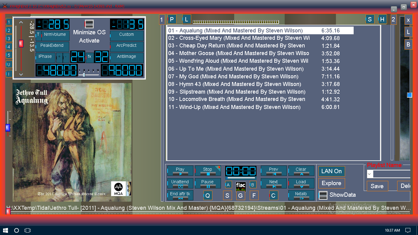

« Reply #58 on: April 02, 2018, 12:12:57 pm »
I have the hang of Tidal for non MQA. Works very smoothly.
The problem with MQA, I think, is the decoding during playback.
The MQA stream seems to be prepared correctly, the coverart shows the MQA 96 icon.
During playback above [G] the MQA logo is not visible (shows FLAC). Also the sampling rate at input shows 48 instead of 96.
MQA/HDCD decoding is active.
I have attached a picture of the same.
Need your guidance.

« Reply #59 on: April 02, 2018, 01:13:01 pm »
Hi Arvind,
Now we're getting somewhere ... Happy
Sort of.
It looks like you have executed everything well and also that you understand, no matter how "blind" you must be because it doesn't work. Moral : not your fault. But now what ...
Look below.
That is mine. Freshly searched for and Prepared. Also Volume Normalized and even still in the Intermediate structure, just like yours. Same version of the album. Both XXHighEnd 2.10.
Same XXHighEnd PC and same OS software if all is right.
Still mine works and yours does not.
But watch the Normalized Volume.
For this 100% the same version this is not possible. So probably your Preparation has been done differently than mine. So can you now please do this :
- Throw out the album again (via XXHighEnd and the Library Area (RightClick - Original Files ...).
- Double Click in the Search field at the bottom so all is refreshed.
- Quit XXHighEnd. Restart it.
- Research for the album.
- Prepare it.
- Volume Normalize it.
- Play track 01.
If you performed the about literally the same but still see that Volume so much higher (see your -13.5 vs. my -21) then at least I won't understand. But if you see the same now (and it works meanwhile) then you must try to tell me how you provoked the previous situation which apperantly let things go wrong. Could be playing one track without explicit Preparation ...
Let me know and regards,
