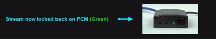

« Reply #104 on: April 09, 2018, 04:16:20 pm »
Here is the video instruction that iFi is sending to everybody:
... At least that looks opposite (upside down) to me.
a. MQA Passthrough, what should it mean according to iFi ? My idea about it : don't decode, pass on to Decoder further down the line (but the video shows opposite).
b. Green light instead of blue (or purple-ish), what should it mean ? -> File is MQA Authenticated, but not signed off by the artist (et al) (but iFi hence video shows = PCM).
About your own text in your previous post I must think a little ... Happy
