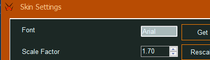

Paul, or Anthony, can you give me a DPI (Windows) setting on one hand, and the Scale Factor of XXHighEnd on the other ?
Also, at which native resolution of the display is this ?

Peter - OK Scale Factor in XX is 1.7  and DPI on my "viewing laptop" is 150%  & display res is 2256x1504  ** BUT ** I have already "played" with these settings and they make no difference to the problem.
So it does not matter what DPI is set on the "viewing laptop" XX in minimised viewed via RDC is the same size on the laptop screen. And changing the scaling factor in XX does fix the problem either.

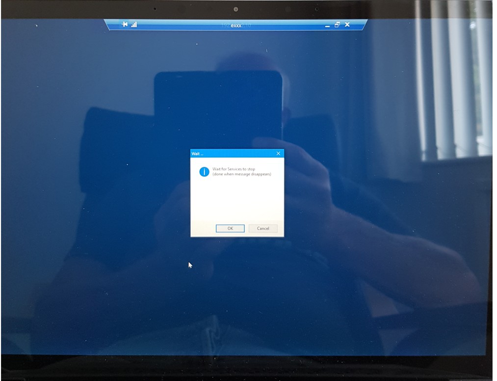

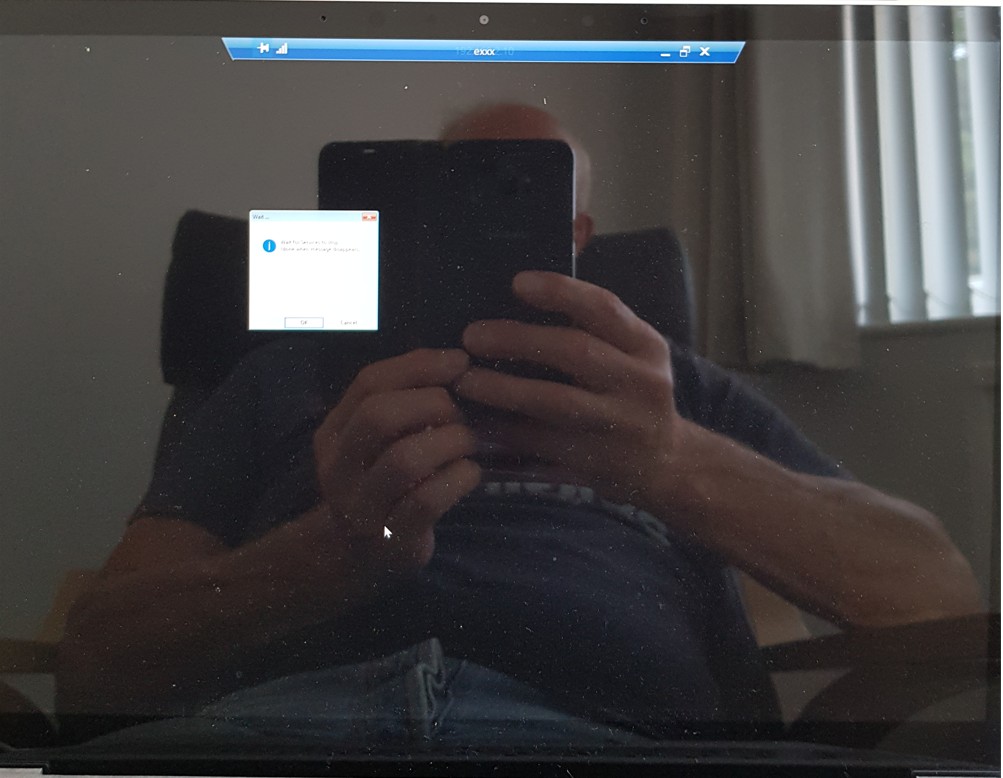

« Reply #8 on: August 09, 2021, 01:14:30 pm »
Not sure if this helps but in the first photo attached XX is just going into minimised mode (ie Play has just been clicked). What happens next is shown in the second photo where the "Wait for service to stop....." message reduces in size just before XX fires back up in minimised mode. Note that this does not happen when I view via another computer regardless of the dpi or scaling settings.

Thank you, Paul.
Interesting. Do you perhaps have any idea yourself what could be the difference between this laptop and the other PC's not showing the issue ? W10 version ?
... Which brings me to the oddity of you telling about the issue as you did all right - even showing it per photograph ... but this is your remote ! So this is not where XXHighEnd plays at all - right ?
This makes it a sort of RDC issue of which I am not sure whether it is under your control in the first place. Anyway, now knowing this, can you think further a bit ?
Also ... referring to the topic Anthony linked to ... are you used to seeing Scrollbars ? I don't mean "today" per se, but always before ? If Yes, it is a good indication that your settings of the RDC client (the remote) have never been right. But today it starts to bother because of (for example !) a not-equal resolution between the client and the host(-capabilities).
