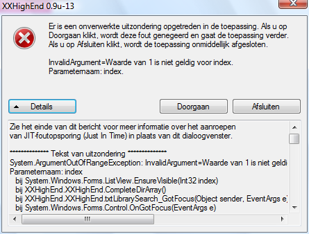

« Reply #25 on: April 09, 2008, 10:43:19 pm »
I tried... I loaded in 1 cd... But going from playlist to library is enough for bringing up the cracks. Also this came up the first time. And only 2 cd's show up in the library area.
