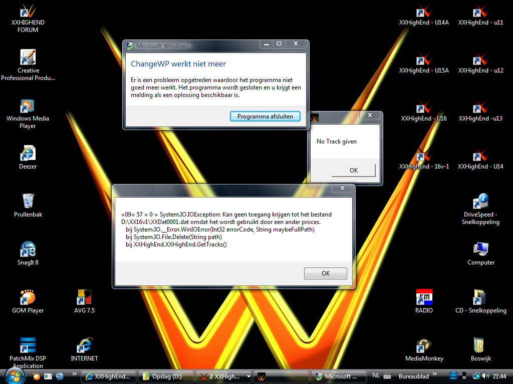

Just to let you now that i do not use the WP. And i do not know what happend but i looked at my pc to start music again. I thought that the cd has ended. Again WAV wich i played before without problems. these errors came up. I do not now if they are related to this topic. But i am sure you do...
EDIT: I started the second cd. So it was not going from cd 1 to cd 2. And when i clicked the error down the bottom away the error * Engine 3 did not start within ........time * came up.

« Reply #29 on: June 16, 2008, 10:40:31 pm »
Gerard, thanks. That ChangeWP thing to me looks like a similar problem why the earlier uploaded XXEngine3 didn't work. I need to apply similarly to the ChangeWP.EXE (and another one or two I think). Also this implies that I address the Wallpaper stuff unnecessarily. I will sort that out.
The error you showed at the bottom is due to XXEngine3 still running, which by itself is caused by the "No track given" message not clicked away by you (so, really not a problem, but by itself caused by the originating problem, which will be the ChangeWP thing).
