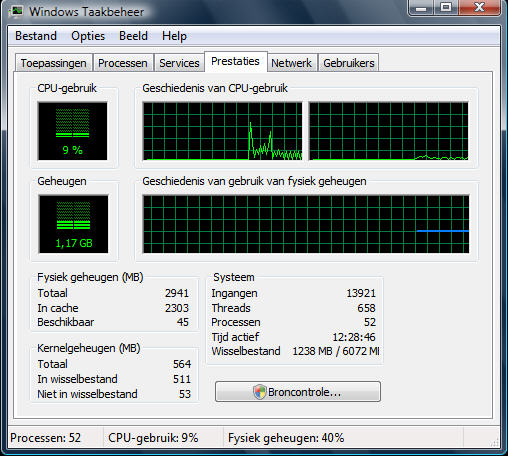

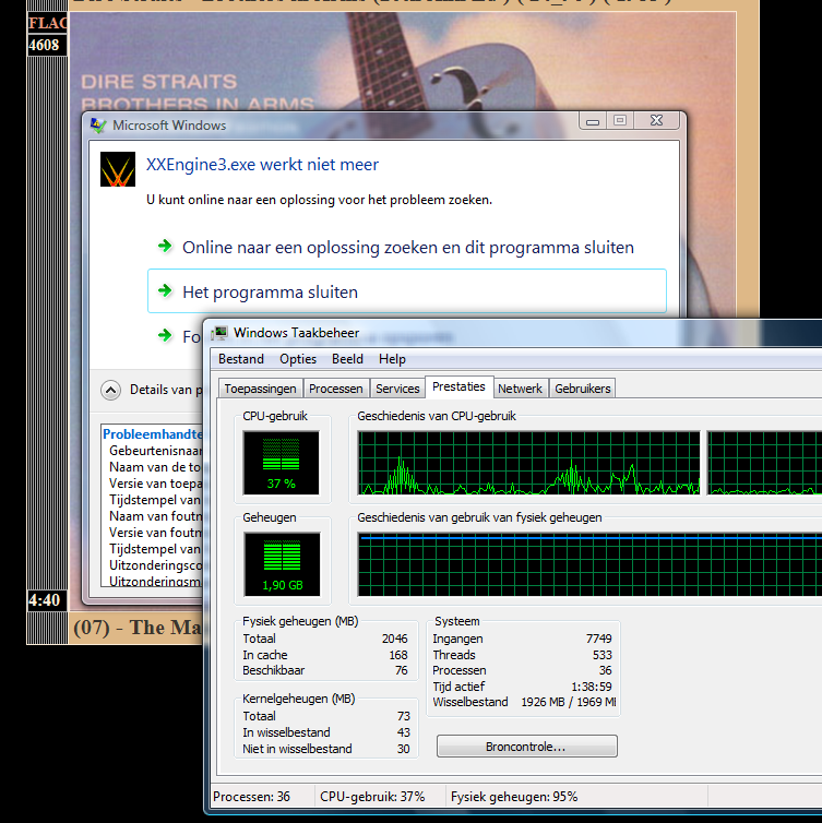

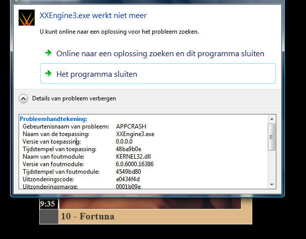

« Reply #65 on: September 01, 2008, 10:06:43 pm »
With "Application Crash" you mean "XXEngine3 stopped working" ?
Yes, see attachment.
......I am *rather* confident these are memory (too low) problems.
see attachment.

« Reply #66 on: September 01, 2008, 11:33:23 pm »
Johan (GerardA too), thanks all so much for your efforts to make this clear;
From my side I have been proving tonight that shutting off the swap file really harms. I had a whole sequence of screen copies showing the evolvement (Johan, having in mind your Fagen album), which indeed ended in the below screenshot. So, I left out the others because apparently this is not your case ... (and I had to kill some crucial services in order to be able to make the screenshot yes).
The real error happening here is the e0434f4d. Well, if you Google for that, you'll find a far too general description everywhere, to deal with. Since I don't have anything of the kind I'm about to hang myself.
wacko

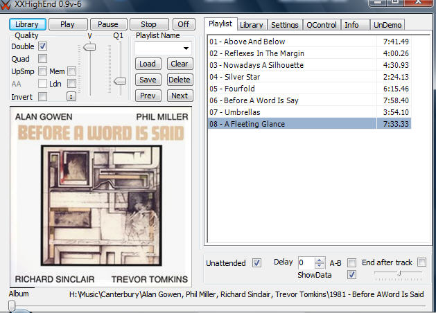

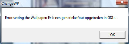

Also in version 09v-6, i have some trouble with the spontaneously stopping during music playback.
This morning playing in unattended mode with the "Double" option gives halfway the cd a stop, see attachment "Stopped" and "memory"
Switched off the "Double"option has no positive effect.
I did a restart of XXHighEnd.  Selecting the "Memory" option gives a wallpaper message while the music is playing. After a view tracks again the music stops (not at the end)
Regards, Johan
Hi Johan,
I found that GDI error occurring here just the same. Working on it ...
I don't see yet how this is related to what you describe here, but for safety I will solve that first and post a new version (I hope later today). Then we'll see further on this one, ok ?
