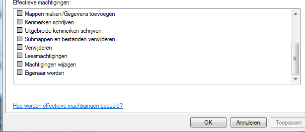

In the mean time, for Johan at least, I found that the rights for Create folders/Append (see arrow in the picture below) are the most logical rights to prevent you from appending to a file. Not that it makes sense, because the log file acts the same after it has been created explicitly, as was the old way of writing to data files Johan couldn't cope with from the start.
Anyway, I'd suggest to give yourself all the rights there are, which are summed up on the page that shows below (including the second screen copy). Note that this place just shows the "effective rights", and they are to be applied at the higher level form you see below (the "Bewerken" button). Some will inherit though ... from somewhere.

« Reply #88 on: September 11, 2008, 04:11:40 am »
I don't know. What I do know, is that when you don't have just all the rights there are, you will run in some problem somewhere (mostly noticeable when doing things over shares / the network.
You mean to put tics in all those boxes ... right?  Why don't your boxes have tics on them?  Ack wait, they don't take tics... I guess this means I've already had those attributes going for me...
