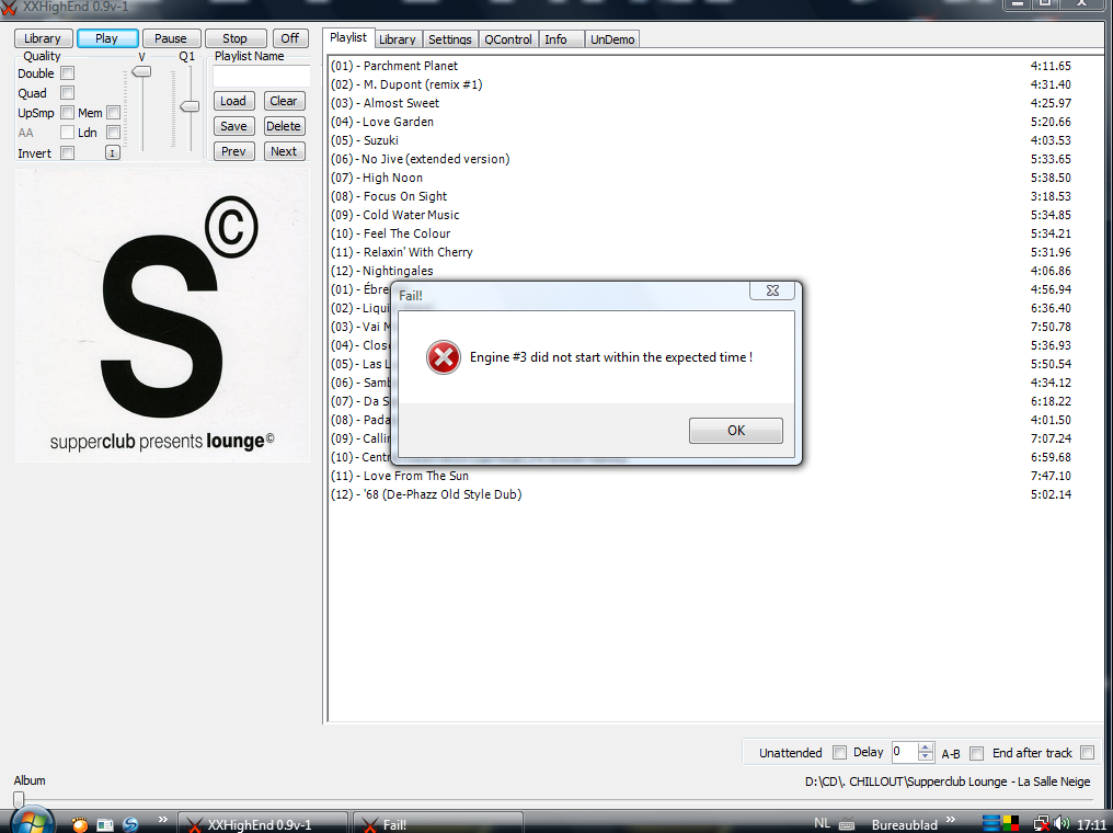

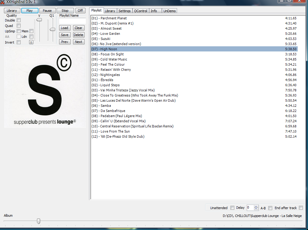

« Reply #14 on: June 11, 2008, 05:34:57 pm »
Gerard,
I'm sure you mentioned this in your first post here because something occurred to you which wasn't normal. But if I may ask, would you still recognize this as something happening to 0.9v-1 which didn't happen in the before versions ? Or, how many times did you have this by now (0.9v-1) ?
It is really hard to say because sometime's it's gone for a while. After my first post i waited and waited. But it did not came up again. For sure i can say it's been there before. All the time's before i just pressed stop and than play again. Never let the whole song end. The last time i did wait and the song after the songs with no music that one did play.
But 15 min ago there it was again. The cd i played was WAV and again someone i have played many time's with no problem. So i just waited and made pic's. I do not see anything strange but maybe you do. It has been the 4 time it happend with this version. But i like to say that i have not played music for a week. Going back to the error i waited until the second (track Cool song and now the second (track Cool  did not play and the error down below came up. I have tried to play track 6 again and waited for 7. Now 7 played without any problems. I did nothing with the PC. unhappy
Sorry i have written a bit fast.  Wink
Grtz
