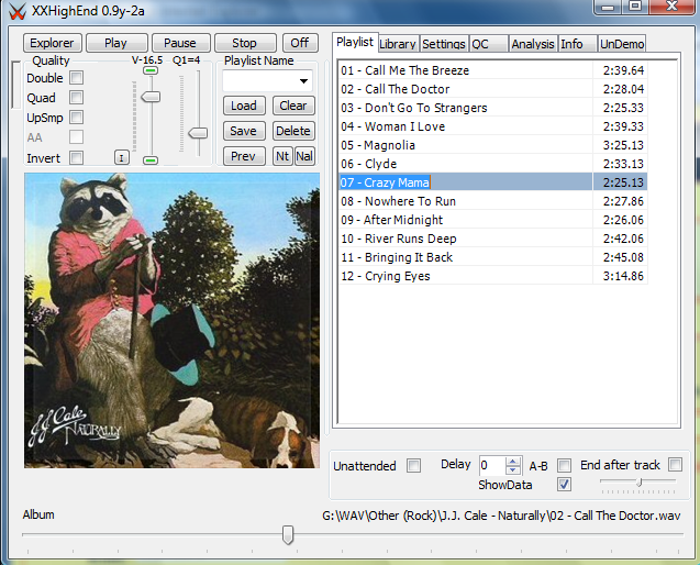

Hello Peter,
Question: playing attended (no wallpaper) and moving the cursor over the playlist, I forgot the name of the track that is currently playing. Is there a place where I can see the name (or path) of the track that is currently playing?
Eric
About your question ... maybe I don't understand ? ... it should be the first highlighted track (or the only one when not playing a selection from the Playlist). So, use the scroll "box" at the right, and scroll until you run into that highlighted track. Do not click any other track first, because then you'll undo the highlighting of the playing track.
when I load loooong playlist, I sometimes like to 'preview' what is coming. So I click on another track down the list to see the coverart of this track to come. While I do this, the music keeps on playing (I feel like a real DJ!). That is very nice, but now this new track is highlighted (of course) and I lose the position of highlighted track that is still playing. I tried to find what is currently playing under the Info-tab in XXHE, but there is only technical date and no name in there. Do you get a feel of what I am asking for?
E
Hey Eric,
Sorry that I summarized some things, but I want to make clear what can and what cannot work.
So, right now I show the currently playing track at the bottom (can undo that in a second, and it only shows (me) what will be happening).
Allright, if you look below first pic, you see 02-Call the Doctor.wav playing (the .wav may go, and "Album" should be named differently). Now, whether I click another track or scroll to it with the arrow buttons, another track will get highlighted. In my case track 07. The track title at the bottom won't change from that. The time scale does though and I guess I can do something about that. However ...
The inherent mechanism (and that won't be changed) causes the highlighted track to be played next. A, say, DJ-like. Happy
So what I mean is that clicking this other track is nothing for returning to where you were (playing), and it is an awkward thing in the end. It will work though, if you only click on the playing track before it ends playing or otherwise the current highlighted track will (second pic below).
Allright ?
Or ... maybe I add a rightclick option "return to playing track" ? grazy I'm not sure though whether I can get that into focus again (that it shows in the visible area). These kind of things are not 100% decent for the means I use ...

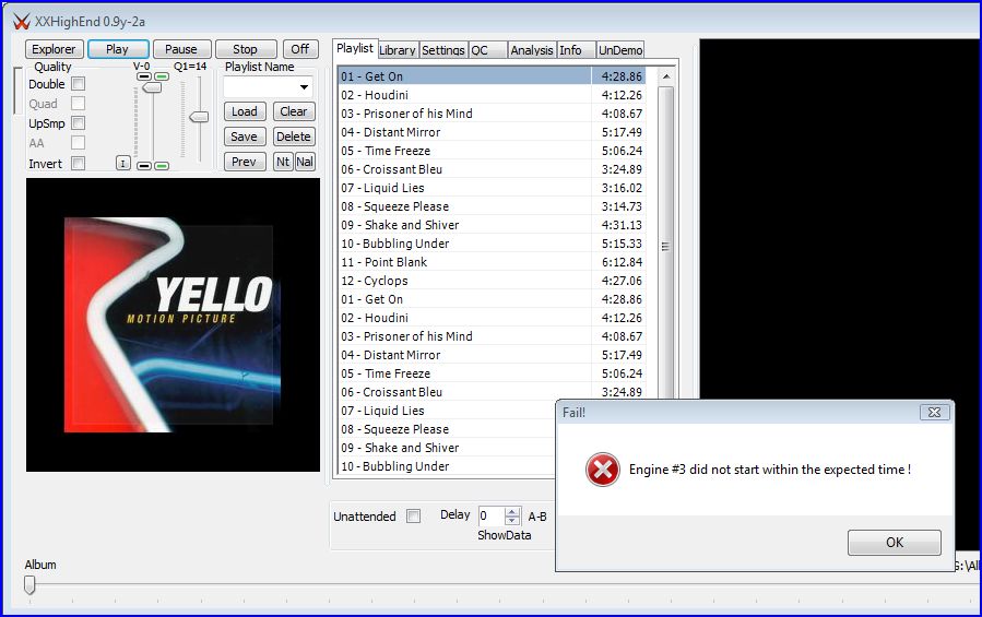

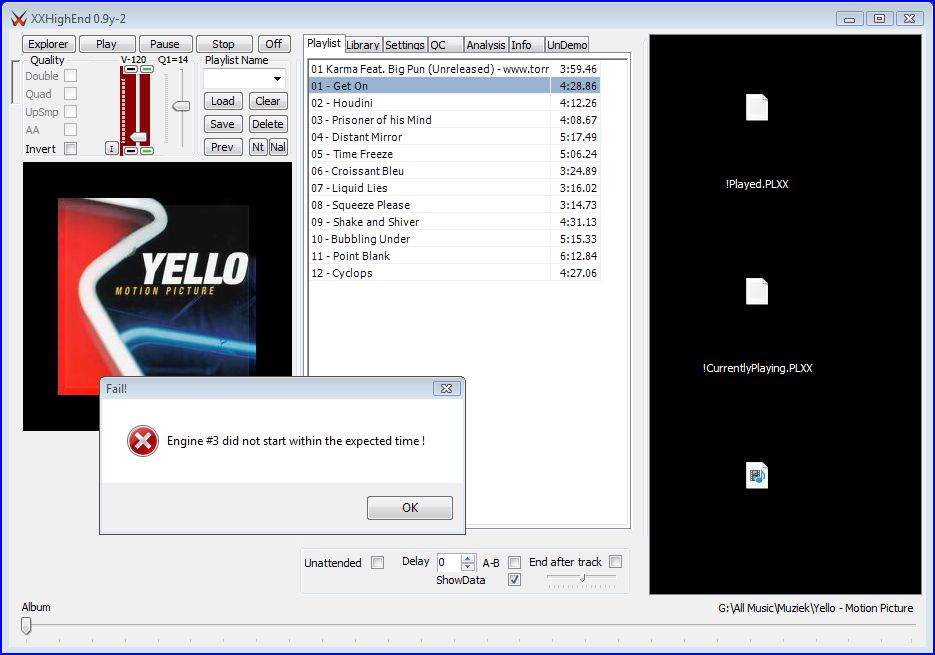

I have been bussy on other stuff for a while but finally downloaded the new version 0.9-2
Unfortunately This version does not work for me since the programm just refuses to start playing.
Whenever I select an album it takes some time before it comes back with this message "engine#3 did not start within the expected time" (see attachment):
The system I use is:
AMD Turion, X@ Ultra Dual-Core Mobile ZM-80 2.10 GHz, 3G RAM. 32-bits
Output USB straight to music system (no external DAC)
Hope you can help me out
regards
Leon

« Reply #67 on: September 01, 2009, 11:23:07 am »
Hi Leon,
try putting the executable for 0.9y-2a over the top of your current install.
See here .... http://www.phasure.com/index.php?topic=888.msg7026#msg7026
I also noticed you have Volume set at -120db in the screen capture ??
« Reply #68 on: September 01, 2009, 11:34:15 am »
Besides, but maybe unrelated, you seem to have something "messed up" with where XXHighEnd is installed ? I mean, those files showing in the right pane really shouldn't be there ... They belong in your (appointed) Data folder and this hardly can be (or should be) under (or within) that Yello album.

« Reply #69 on: September 01, 2009, 11:39:45 am »
Hi Leon,
Thanks Russ,
I tried that before, and tried it again. unfortunately no result.
the volume set was like that as default
Regards
Leon
