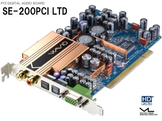

To me this looks top of the bill. Should be better than anything else really.
I have tried the Audiotrak vs my Onkyo, and the Onkyo eats it for breakfast.
I have been contemplating upgrading to the SE-200 Ltd, looks absolutely spiffing, uses better quality parts and a better DAC than my SE-90 (Wolfson 8716 vs 8740). Opamps are the same on both cards. If it sounds better than the 90, I may have found my dream source.
The coolest thing about these are the analogue volume control (and proper mute circuits) and its absolute quietness. I have run the card directly into power amps (totally doable due to what turns out to be analogue volume attenuation), and it is dead quiet, adds no noise over the amplifiers' noise floor.

By the way. The Burson modded Audio Prodigy HD2 se is priced at $322 or 217 EU plus VAT. What are we talking about for the Onkyo SE-200 ltd?

The SE-200 Ltd. is about 30k Yen, soooo about 225 EUR.

Onkyo Wavio SE-200 and SE-200 Ltd:
Chipset: VIA Envy24HT
DAC: Wolfson WM8740
Singal-Noise Ratio: 115dB (2Ch Analog Out)
Frequency Response: 0.3Hz - 88kHz (2Ch Analog Out Out +0/-3dB)
Digital IN Sampling Frequency: 32, 44.1, 48, 88.2, 96kHz
Digital OUT sampling frequency: 32, 44.1, 48, 88.2, 96, 176.4, 192kHz
Input terminal: Analog IN X 2 (stereo RCA, internal connection)
Digital IN X 1 (Toslink)
MIC X 1 (φ 3.5mm monaural)
Output terminal: 2ch Analog OUT X 1 (stereo RCA)
Digital OUT X 1 (Toslink)
7.1ch Analog OUT X 1
