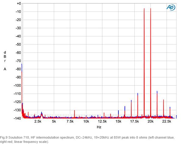

Also, output seems to be 22V-p with a rise time of 330ns. Roughly this means a slew rate of 66V/us.
Let's say I didn't make too many mistakes here, and let's say the slew rate of the NOS1 of 650V/us is something to take into consideration.
Does this look good to you ?
Then, I don't like the graphs;
I can't see the FFT depth, but from the two pictures -one with noise only, one with signal- there's already a 20dB difference. Besides, something like -165dB for the noise floor ? haha. Well, the specs in the end talk about -110dB, so I guess that's the figure, but that's no good figure at all.
The noise-only figure shows harmonics which I don't like to see. I know, amp manufacturer judge this as very good etc., but I just don't want to see it. From the NOS1 comes exactly silch (the noise floor being at a real better than 140dB), and the only thing my Gainclones add during playing the test signal is a 3rd harmonic which isn't higher than the harmonics coming from the DAC. See ? it can be done.

Also, output seems to be 22V-p with a rise time of 330ns. Roughly this means a slew rate of 66V/us. Let's say I didn't make too many mistakes here, and let's say the slew rate of the NOS1 of 650V/us is something to take into consideration.
Actually, I think the slew rate is 31V/0.33µs = ~90V/µs. Now the Magtech operates at plus/minus 92 volts and is quoted as having a slew rate of 500V/µs. The operating voltage becomes important when considering an amp for electrostatics because these speakers are 'voltage operated devices'.
Then, I don't like the graphs; I can't see the FFT depth, but from the two pictures -one with noise only, one with signal- there's already a 20dB difference. Besides, something like -165dB for the noise floor ? haha. Well, the specs in the end talk about -110dB, so I guess that's the figure, but that's no good figure at all.
Now this is where I'm getting a little confused. In the recent Stereophile review of the 710, John Atkinson ends his measurements by saying, "... the Soulution 710 is definitely one of the best-measuring amplifiers I have encountered." I've attached some of his measurements - any comments about these?
Incidentally, the Magtech's noise is also rated as, "More than 110dB below rated output."
