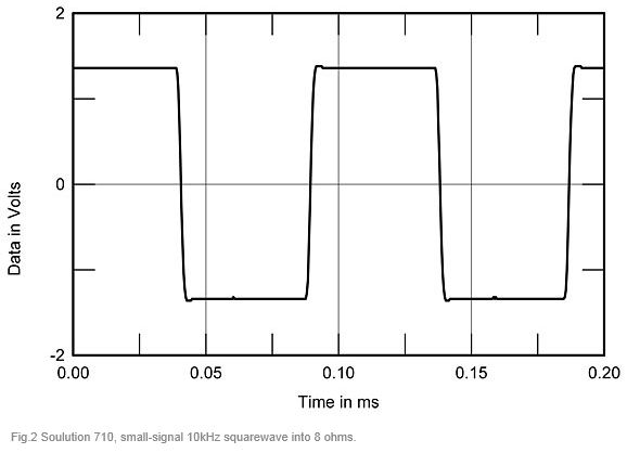

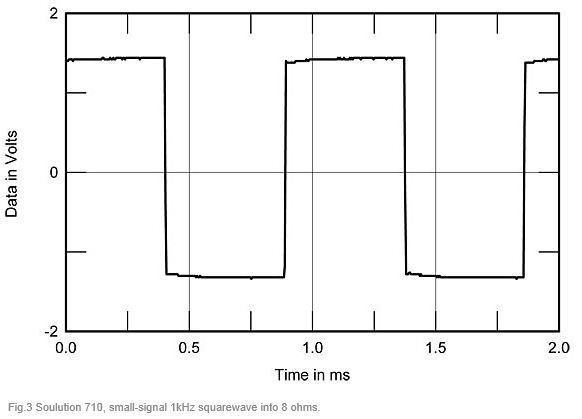

Also, output seems to be 22V-p with a rise time of 330ns. Roughly this means a slew rate of 66V/us.
Let's say I didn't make too many mistakes here, and let's say the slew rate of the NOS1 of 650V/us is something to take into consideration.
Does this look good to you ?

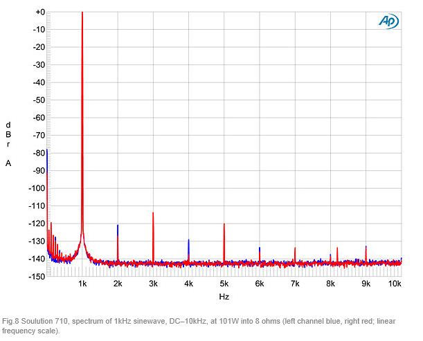

I can't see the FFT depth, but from the two pictures -one with noise only, one with signal- there's already a 20dB difference. Besides, something like -165dB for the noise floor ? haha. Well, the specs in the end talk about -110dB, so I guess that's the figure, but that's no good figure at all.
The noise-only figure shows harmonics which I don't like to see. I know, amp manufacturer judge this as very good etc., but I just don't want to see it. From the NOS1 comes exactly silch (the noise floor being at a real better than 140dB), and the only thing my Gainclones add during playing the test signal is a 3rd harmonic which isn't higher than the harmonics coming from the DAC. See ? it can be done.

Also, output seems to be 22V-p with a rise time of 330ns. Roughly this means a slew rate of 66V/us. Let's say I didn't make too many mistakes here, and let's say the slew rate of the NOS1 of 650V/us is something to take into consideration.
Actually, I think the slew rate is 31V/0.33µs = ~90V/µs. Now the Magtech operates at plus/minus 92 volts and is quoted as having a slew rate of 500V/µs. The operating voltage becomes important when considering an amp for electrostatics because these speakers are 'voltage operated devices'.
Then, I don't like the graphs; I can't see the FFT depth, but from the two pictures -one with noise only, one with signal- there's already a 20dB difference. Besides, something like -165dB for the noise floor ? haha. Well, the specs in the end talk about -110dB, so I guess that's the figure, but that's no good figure at all.
Now this is where I'm getting a little confused. In the recent Stereophile review of the 710, John Atkinson ends his measurements by saying, "... the Soulution 710 is definitely one of the best-measuring amplifiers I have encountered." I've attached some of his measurements - any comments about these?
Incidentally, the Magtech's noise is also rated as, "More than 110dB below rated output."
I didn't look it up again, but I think the amp bears 31VRMS. If I (again) don't make mistakes, this is 42V-pp (from bottom minus to top plus).
Slew rate (I think), is measured from zero to plus (or from zero to minus, but that shouldn't make a difference; btw fall time (opposed to rise time) can be different again). So, 42-pp would be 21V-p (from zero to top only). And now *that* rises in 330ns ...
If this is wrong and slew rate would be measured from bottom minus to top plus, then my figure has to be doubled. So, then it would be 133V/us. You can always count on me being wrong. Happy
