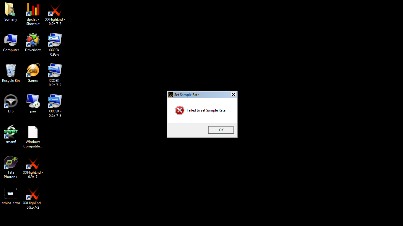

Ok its like this. When I start the PC, Load playlist & click start I get the msg (attached). If I stop & click play again then the msg does not come back. So it comes at the first play only.
It doesnt matter if engine #3 is killed or running. In both case the msg appears at the first play.
Hope this helps.
« Reply #9 on: September 14, 2012, 08:18:23 am »
Ah. Thank you very much Arvind. That is useful information.
Not that I understand how it happens ...
Btw, this is a typicle NOS1 message. When you think of this in advance at a next reboot, you might first start the Phasure Driver Control Panel and look at the set Sample Rate in there. Maybe it is helpful to me if you tell me what you see. You should see the same I as do here, but still something must be different.
May you encounter that when you first start that Control Panel and now all is okay suddenly, then I also like to know that.
Regards and thanks,
