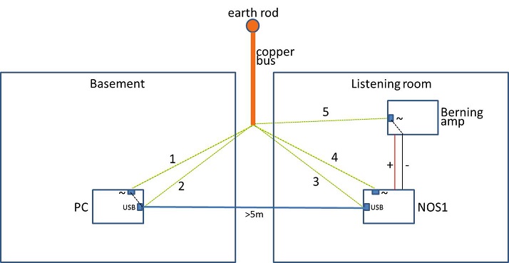

« Reply #11 on: September 04, 2013, 01:36:25 pm »
OK, I'm pretty certain Peter will tell me that I'm doing totally the wrong thing, but I'll go ahead anyway...
I've drawn up my current grounding/PE scheme. I use a 'star arrangement' with a 3m copper chemical rod in the garden. The guy who installed it believes it's around 5 Ohms to earth, based on the clay soil in which it's inserted. In any event, it should be much better and electrically much cleaner than the house PE. (I won't go into details here, but I use 2 balanced transformers - one for the basement and one for the listening room - to isolate this earth from the house PE.) There are actually 12x 3m earth wires connected to the solid copper bus - 6 going into my listening room and 6 going into the basement (I've only shown 5). Now the interesting stuff...
Every component has its PE connected to one of the 12 earth wires. Being of equal length, each of these should sit at exactly the same potential wrt to earth.
Now, in a regular setup, the NOS1 will derive its ground from the USB cable (I'm not talking about the NOS1's PE here - this is derived from 4 and is just connected to the chassis). But the ground is itself derived from the PC's ground plane (which I'm assuming is ultimately derived from the  PC's PE connection, 1).
Now, I'm using a >5m length of USB cable. Everyone says this is a bad idea. I'm not so sure. Pat over at AR-T uses very long lengths to make his spdif cables, to reduce the affect of reflections - at MHz freqs this matters. And maybe there's a case for long USB cables too? But of course the major downside is the susceptibility to RF interference with such a long length. So what I've done is to connect the USB cable's screen at the PC end to earth (2) and at the NOS1 end to earth (3).
But this has now done exactly what Peter wanted to avoid - use the PE for ground in the NOS1. What puzzles me though is that this is unavoidable isn't it? I mean, where does that ground get it's reference from anyway? The PC's PE, no?
Anyway, what I really wanted to talk about was the affect that having 3 connected or not has on the sound. It totally changes when it's connected. It's cleaner with what sounds like a quieter background. It's darker with less 'sparkle'. But along with this, there's much less sibilance and edge to the sound. It's much easier to listen to. 'Blanketed'? I wouldn't say so, but compared to 3 unconnected, it certainly sounds less bright and lively.
Any thoughts as to why connection 3 in my scheme is having such a profound affect on the sound?

« Reply #12 on: September 04, 2013, 02:02:02 pm »
You not only referenced to the earth rod but also ceated a new path for currents. Current runs in loops like from pc to dac via 2 and 3 (and back through the usb cable) or via 2 and 1. Etc etc.
Like stiffness in mechanics, the current (like displacement) will yield toward the least resistive (most stiff) path.
And then we have induction: the wires acting as a current generators within ac fields.
Currents all over the place. Some for the better, others for the worse. This is trial, error and learn material.
Maybe a bright guy is able to solve this puzzle... Peter? Anyone?
Regards, Coen
« Reply #13 on: September 04, 2013, 02:09:34 pm »
Reading the John Swenson articles, it's clear that there have to be return currents or things just wouldn't work. But they create ground plane noise. What I'm trying to do is to feed this noise away from the components and into the earth by using a star arrangement to reduce as much as possible any potential difference between components.
« Reply #14 on: September 04, 2013, 03:46:13 pm »
John S also talks about the groundplanes being polluted by circuit noise. This means that you have to choose a quietest point on your grounding where you connect the earth reference. If you make multiple refs on the ground you create the possibility to run currents through the ref (aka loops) especially when this is a low impedance path for the noise involved.
So if the pc is refecenced to ground at a certain point and you add another ground reference at the usb terminal you have two referencepoints. My point is that the effects of this are now rather unpreditcable.
I would rather experiment what the difference is between referencing at the pc ground at the plug versus referencing at the usb side.
Since the NOS1 circuitry is internally "floating" I would expect that it is not adviced to ground the poweramp circuitry. You will create a path for currents to pass through the NOS1 (that is that a low impedance path is via the NOS1).
I realise this need more thinking and experimenting.
Regards, Coen
