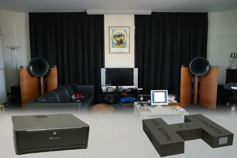

Like last year Phasure will attend this year's X-fi show. The sound in our room - room number 30 this time - should exceed everything and all (make up your own subjects Wink). At least I myself have done the best I could, so come over to Veldhoven (Sept. 14/15) and listen for yourself how music reproduction through loudspeakers can perform these days.
Similar to last year we will be doing all together with Bert Doppenberg (BD-Design), but our collaboration extended somewhat to now offering complete systems as if presented by one company and one consistent design (and one responsible party towards you). This has been our idea for over 3 years by now, and today it really is there.
The Orelino speakers you see showing off here is a commercial speaker, based on the no-compromises Big Orelo design from last year. That was a tad large, and never meant to really fit in any room. But it would show us possbilities of free open baffle sound. From there the Orelino sprung and I dare say it works even better than the Big Orelo - it will fit your room and looks better (but this is personal of course).
Never forgetting that it is all Bert's (craft)work, we can well add that I was Bert's sheer pain and I "required" (mind the quotes) it to be as good as the Big Orelo. So, way smaller but as good.
Also, it is our both idea to enable customers to buy a complete system - with the guarantee of no audible noise at full gain etc. you all know from me, plus of course you should be able to perceive the same best sound we perceive over here. And if not, the culprit must be elsewhere and can now so (relatively) easily be sorted out. This lead to all the amplification needed to be in the phase plug (the vertical bar you see in the middle of the speaker) which' location is one of these great ideas from Bert.
So, after we both (Bert ahead !) applied some general design principles to let this speaker perform like Big Orelo and Bert crafted all into what you see in the picture, I was given the nice task to let it really work out in the larger room (like mine, which measures 12x8x3m). And well, after more than a week that was achieved yesterday. Possibly because I never give up once I think something can be done. The biggest surprise however, came throughout the process of "tuning" (XOver) it;
It is to be remembered that this is actually an open baffle design. It works as a horn, but still there is no pressure chamber and although that makes the woofers move free (implying no distortion which normally would be there), this is the worst for creating some SPL (Sound Pressure (Level)). So, some DSP certainly would be needed ...
And yes, even PeterSt who is plainly against everything which only smells like "DSP" would admit it should be for the better. Or maybe : just allowed for the bass section (only !).
And on a side note : in search for a best DSP module, I could not find anything that would not compromise severely. Sample rate is always too low etc., and what would happen is that at the back end there's a poor D/A at work, that replacing the nice NOS1 ... (that's what it comes down to). But hey, for the bass ...
So there I was, tweaking with the DSP module and trying to get out something that would not colour and/or buzz. I couldn't do it. Not in a week's time. All sorts of subjects were theoretically to blame - one of them the current Orelino not being the final version yet and the buzzing I heard could be dedicated to resonance - and what to do now. Luckily Bert went off for a well deserved vacation (at this moment of writing he still is) so I couldn't travel the path of finalizing the speaker for this possible resonance. It woudn't have helped anyway ...
Long story somewhat shorter : DSP just doesn't cut it. So, all the means where there to create a best XOver with the mid-high, but all I could get out of it was no-buzz but no bass as well. Nothing we would go for ...
And thus the completely unexpected thing :
I applied a normal passive XOver which I actually only did to see what would come out of that not knowing anymore what else to do. And right at the first attempt it was bingo; All what I had been struggeling with in a week's time had vanished. It just worked. Well, except for the proper XOver point which took me another day (yesterday), but finally the speaker performed way better than my own. And mind you, no subwoofers in the chain (which I always used).
I threw in all the "knowledge" and equipment for measuring, which even includes real time FFT (which I think no speaker designer ever does) and fine tuned the lot with playing real music. The speaker goes flat (!) to 23Hz and the nice thing is that its characteristics are so that beyond that it drops off like a stone (like 120dB/Octave). So no distortions there either; a fundamental of 23Hz just plays and does what it has to do (like implying all its odd harmonics for a squared wave) and 22Hz already does not show at all.
Time alignment - another thing which would require DSP - appeared not necessary because of the mid-high horn has sufficient back/forward headroom to phase align all as should. Mind you, I phase aligned the both, not impulse aligned (Bert knows that this is one of my hobby horses and now I had the opportunity). This too needs real time analysis and since I own the equipment ...
Be shocked ... This plays at a 100dBSPL continuously and easily (playing louder is not much required here). No standing waves anywhere, no buzzing. And might it tell something, yesterday I played over 90dBSPL for 6 hours in a row, and I received no complaint throughout. This is LOUD you know.
And still this is open baffle based. Who would have thought that (Bert not, me not).
I posted this in the Phasure NOS1 board because of course the base is and remains the DAC. So what I know and recognized is the same buzzing implied by regular DACs (or playback software for that matter). It was by accident though that I proved that indeed none of this "DSP" stuff is allowed anywhere. It doesn't work in a DAC, it doesn't work in software and it also doesn't work in a speaker; logic of course, because it would imply the same (of both mentioned). But I was totally open to it and had the idea it couldn't work without DSP anyway. Spending a full week on it was foolish, I see now.
Anyway I think it proves how important it is to have a consistent system where all design elements perfectly match. In this case this goes rather far of course and I think (for design philosophy) further than any Sony set.
Last litte note :
This is the fourth post about this; my previous three attempts invited you all to come over and listen, for which I planned a group hug yesterday (Saturday) - also for people I don't know at all. This, because it would be a one time opportunity to listen to the Orelino's in the larger room, anticipating all might fail in the always disappointing hotel room (of a Show). I twisted and twirled to justify what you would perceive and how it would be for the better. But all three times I couldn't post it; I wasn't even honest to myself.
Now it is too late for this, unless some individual is seriously interested in obtaining a pair of Orelino's before they disappear from here; it possibly can be squeezed in the upcoming days (if you don't like to post in here, contact me through sales phasure com). After the X-fi show Bert will be happy to receive you, but remember this is in a relatively small room (which can be like yours of course - roughly 7x5.5x2.8m).
Let me add to this that I did totally nothing to adapt the speaker to the room; They were dunked somewhere of which thought it would be okay (see photo) and they were never moved. Also, the filter does not contain any notches (would cover for standing waves) anywhere, so chances are fair it works out as "perfectly" in that hotel room. So we hope to see you there at least.
Regards to all,
PS: Bert doesn't know about this post but I am authorized to do what I want. This goes as far as "selling" with the small though fairly important remark that this logically goes on a first come first serve base, also with the knowledge that three of these speaker systems are in order right now (not counting orders Bert knows about).
