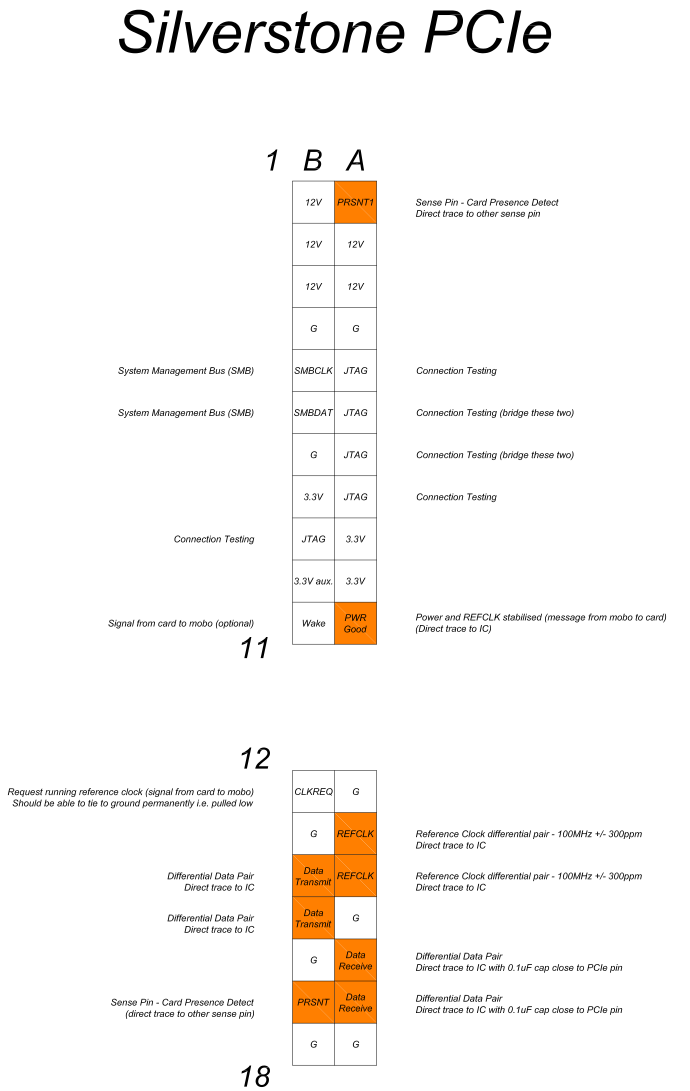

INSTRUCTIONS TO BUILD A PCIe LOOM
To complete this project you will need a PCIe riser cable (like this one) that you don’t mind taking a knife to, and a dual rail lab LPS (or a dual battery supply).
Have a look at the PCIe pinout diagram below…see those orange pins?...they are the only ones that will hold a wire when we are finished.  “B” side of the Silverstone card holds the components, and “A” side has solder everywhere.
* Silverstone PCIe Pins3.pdf (878.69 KB - downloaded 519 times.)
« Reply #34 on: January 29, 2014, 08:27:35 am »
Hi Anthony,
Thanks for the elaborate instruction.
In the diagrams I see that the data receive is not dc coupled, but the data transmit and bus clock are. Likely the are decoupled at the end of the bus.
So we can conclude that the NOS1 case connection is crucial for the ground reference. Do you have the PE connected to power earth for both the pc and NOS1? Or maybe the amps PE?
It seems like a favourable grounding scheme to reference ground at the end of the chain.
Regards, Coen

Yes, I think that the NOS1 case connection is crucial for ground reference with this setup.
Here is an excerpt from the PCI Express Card Electromechanical Specification...
AC Coupling Capacitors
The PCI Express add-in card and system board shall incorporate AC coupling capacitors on
the transmitter differential pair.  This is to ensure blocking of the DC path between the PCI
Express add-in card and the system board.  The suggested minimum 603-type (or smaller
402-type) capacitor with a value as specified in the PCI Express Base Specification.  Any
additional attenuation or jitter caused by the coupling capacitors (other than 603-type) must
be accounted for as part of the allocation for the physical component on which the
capacitors are mounted.  The electrical budgets allocated for the AC coupling capacitors are
defined in the following subsections.  The allocated budget includes the electrical parasitic
associated with the component placement as on the PCB.
So decoupling is a requirement of the PCIe standard.
