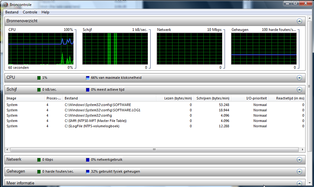

The other approach
What I had been trying here and there throughout the 19 months, was something everybody does : shutting down services and see whether that helps somewhere. It lead to nothing, because in fact you are doing this in the blind. Afterwards I can guarantee this, because so many many things are needed, and all togther they create disk I/O in amounts that one really doesn't know where to start.
What I did is taking the Source Control program which can be started from within TaskManager, look at the Disk I/O screen and the programs causing the Disk I/O in the lower part of the screen, and piece by piece investigate what these programs are and how the IO they generate can be eliminated. This all together took me one day, and I can tell you, this is not about shutting down services as such ! You will see this in the outlays mote below.
What is left for I/O can be seen below;
The first screenshot is the one to achieve : nothing. But careful : this should be nothing during the time *you* don't incur for anything (like in playing a 60 minute track it should stay empty in there for 60 minutes). Did I achieve that ? nope. I can't get further than the second screenshot below, which is always about those things, and they occur at (as it seems) random intervals. The longest that it was completely quiet I think was 14 minutes, but it also can be 1 (rare) or 5 (often) or 8 (often) or 14 (often). However, these are very tiny I/Os I can't even see on the disk light. Compared to the zillions we are used too ... Walhalla.
Btw, the main reason I gave up on this one day of finding out how to stop those last few, is that they are *all* related to or anti-virus programs (which I don't have), or viruses themselves (which I think I don't have hehe), and each search for these in Google gives an infinit amount of hits. And then I had better things to do.
But go ahead with it if you like. Happy
The things you see below are not "stupid" copies of advises of anyone else. They were all determined by me, and they *all* contribute to less I/O. Remember, I grabbed one line hence file the I/O takes place on, I looked and measured its reocccurance, and tweaked until it stayed away. Also there's the other group of knowing what will happen because of what (you do yourself).
Oh, it is also nice to know that the way I did this, makes a necessary IO much more lean. Thus, a necessary access to a file (like a WAV) could incur for, say, 20 other activities, while now this is only a few.
and not one single IO was shown during this typing ...

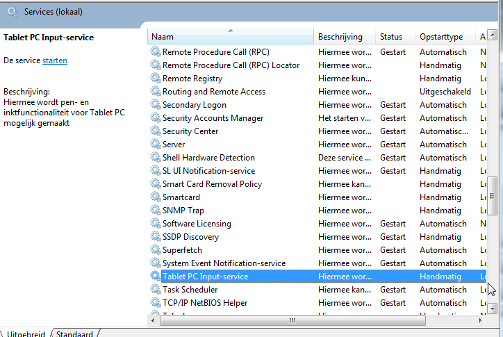

Below is a row of Services you really don't need, and which I shut down for a maybe strange reason : Vista will shut them down anyway (at least that can happen) during playback with XXHighEnd. So I thought they can be in the way ...
Set the Start Type (4th column) to the value I show, and where "handmatig" means "manual".
Note : The first one (03), about the Tablet PC should be left as it is when you actually use a tablet PC under Vista.
Careful : You can see for yourself that the others may not be nice for you to shut down. I did it anyway, because (e.g.) I don't print from the audio PC, I don't capture images from a camera, and I sure don't want Defender to scan along. Note with this latter : looking at Defender01 you must know that at each boot that window appears (Edit : don't apply this, better look here : Shutting off Windows Defender). It tells you that the (Defender) Service has stopped, which is really no problem. It may be my fault that I don't know how that get away with this more formally, so that window keeps on appearing.
Edit :
I realized that my way of shutting off Defender isn't a nice one. Better do this :
Find Defender and start it (you can use Windows Help and search for Defender). See the screenshot at the very bottom in this post. Choose the option where the arrow is, then choose "Options", and in there untick *all* the leftmost checkboxes.
IMPORTANT : When you already shut down the Service for Windows Defender, you must restart it manually first (go to Services, find Windows Defender, rightclick - Start). Now Defender can be started to give entry to the options just described.
Leave the service shut off anyway (see more above), or reboot to shut it off when you just had to start it in order to change the Defender settings.
Now the message as shown in Defender01 (below) doesn't show anymore at booting.
Also look at the last one. This says "start delayed", or IOW start when you ask for it. You might need that at times, and in normal situations ot won't run now.

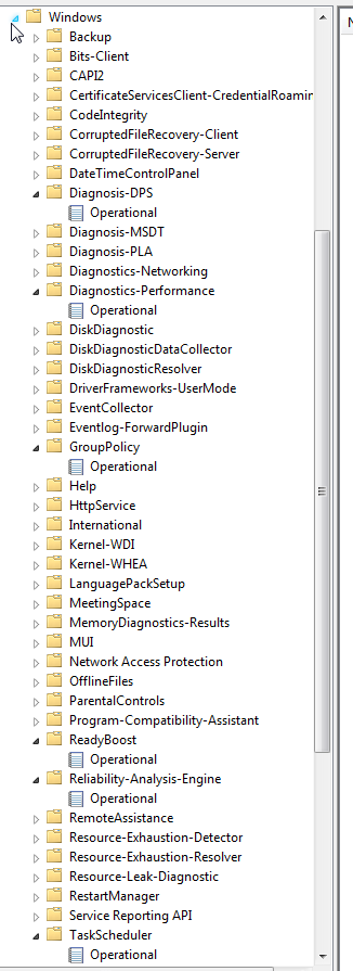

Here's the most nasty part of it all, creating I/Os which you couldn't imagine.
Note : Do not think you can shut this off by shutting off the Event Log Service, because that requires the Task Scheduler to shut down, and I won't even attempt to try *that*.
So, the first screen shows you where to go to (via rightclick MyComputer and Manage). Note you need to be at the bottom of that screen and the Windows folder shown there ("Backup" is just the first entry of the long list you see in the second screen).
The second screen shows all the logging events to shut down.
Rightclick on each of the "Operational" entries I show, and choose "shut down log" (similar).
Important : All the log files can be shut down, but I only chose the ones which may create just too many IO's. So, you could shut them down all, but a. it really isn't necessary and b. they are there for you to be informative when something is the matter.

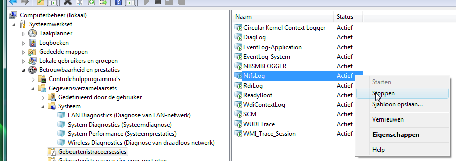

The below can be reached by Manage like in the before post. I think you can recognize by means of the icons where to go.
With the first one (14c) I could not prove that it really helped, but the intention with this one is to make the system at rest earlier after a boot. My Vista for sure is, but I don't know whether this one cause it.
Please note that this kind of "weak" one, actually had to be a full stop of Event Logging, but I don't think it can be done. This is about the one above this one (look at the right) which is similar but for normal operation. The one here (14c) is only for during startup.
14d u/i 14f speak for themselves.
