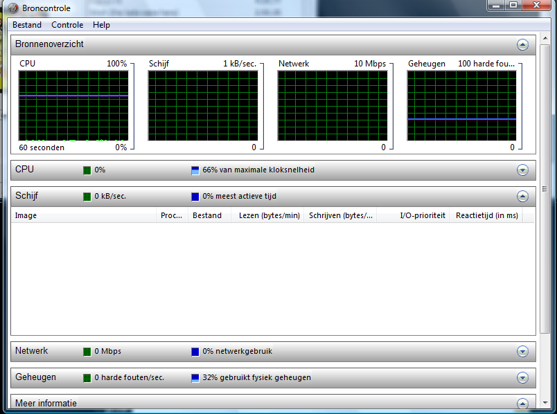

What I had been trying here and there throughout the 19 months, was something everybody does : shutting down services and see whether that helps somewhere. It lead to nothing, because in fact you are doing this in the blind. Afterwards I can guarantee this, because so many many things are needed, and all togther they create disk I/O in amounts that one really doesn't know where to start.
What I did is taking the Source Control program which can be started from within TaskManager, look at the Disk I/O screen and the programs causing the Disk I/O in the lower part of the screen, and piece by piece investigate what these programs are and how the IO they generate can be eliminated. This all together took me one day, and I can tell you, this is not about shutting down services as such ! You will see this in the outlays mote below.
What is left for I/O can be seen below;
The first screenshot is the one to achieve : nothing. But careful : this should be nothing during the time *you* don't incur for anything (like in playing a 60 minute track it should stay empty in there for 60 minutes). Did I achieve that ? nope. I can't get further than the second screenshot below, which is always about those things, and they occur at (as it seems) random intervals. The longest that it was completely quiet I think was 14 minutes, but it also can be 1 (rare) or 5 (often) or 8 (often) or 14 (often). However, these are very tiny I/Os I can't even see on the disk light. Compared to the zillions we are used too ... Walhalla.
Btw, the main reason I gave up on this one day of finding out how to stop those last few, is that they are *all* related to or anti-virus programs (which I don't have), or viruses themselves (which I think I don't have hehe), and each search for these in Google gives an infinit amount of hits. And then I had better things to do.
But go ahead with it if you like. Happy
The things you see below are not "stupid" copies of advises of anyone else. They were all determined by me, and they *all* contribute to less I/O. Remember, I grabbed one line hence file the I/O takes place on, I looked and measured its reocccurance, and tweaked until it stayed away. Also there's the other group of knowing what will happen because of what (you do yourself).
Oh, it is also nice to know that the way I did this, makes a necessary IO much more lean. Thus, a necessary access to a file (like a WAV) could incur for, say, 20 other activities, while now this is only a few.
and not one single IO was shown during this typing ...
Here goes :

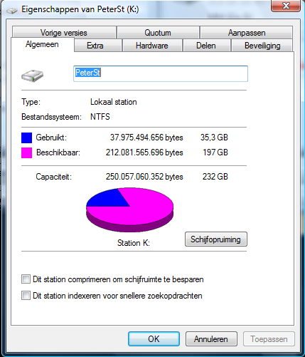

« Reply #1 on: July 22, 2008, 06:43:14 pm »

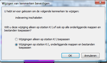

This is for 0% related to shutting off Indexing at some higher level. That only works a bit, but sure not for all, and 100% sure not for ever. Wink
So, you MUST shut off indexing per disk you have, and (!!) when the disk gets unmounted, you must do this *explicitly* again.
What you see below looks like the obvious, but there's something you might not know, and it is really necessay to do it right :
The second screen asks you where to apply the shut off of the indexing, and this *must* be applied to all the subfolders and files as well.
Once you receive a disk, or re-mount it, you cannot be sure what the settings are for the subfolders etc., so in order to be sure you *must* switch ON indexing, press apply, let the second screen come up, choose the first option to be fast, and then pull up the screen again for shutting Indexing OFF, Apply, and choose the SECOND option in the second screen.
Only now, the ever and ever scanning of all the files stay away.
And for those reading this who are less familiar with what happens with our music data, and galeries and all ... personally my number of files is MILLIONS (6 draws to Galeries is enough for that).

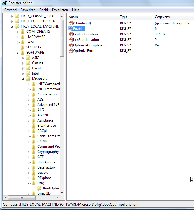

« Reply #2 on: July 22, 2008, 06:53:43 pm »
Bootoptimizer may ****
The only thing what is does, is rather constantly "fetching" things you might incur for changes during a next boot (which you almost never do), while it slows down your system for that all the time. And you know what ? after applying all of the other things booting is twice as fast the least.
Apply the change to the Registry as you see below. Thus, enter N for Enable.

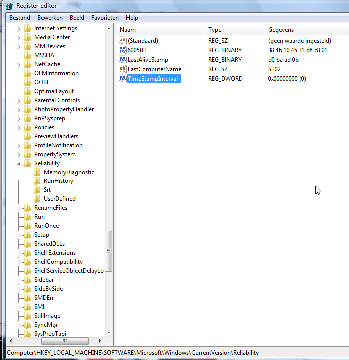

« Reply #3 on: July 22, 2008, 06:56:01 pm »
The poor thing can only guess wrong here, but does it anyway.
Set the value as shown to 0.
Btw, if it is active it will be set to 3. You might have shut this off already by other means.
Look at the bottom for the full key to this entry.

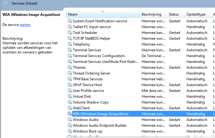

Below is a row of Services you really don't need, and which I shut down for a maybe strange reason : Vista will shut them down anyway (at least that can happen) during playback with XXHighEnd. So I thought they can be in the way ...
Set the Start Type (4th column) to the value I show, and where "handmatig" means "manual".
Note : The first one (03), about the Tablet PC should be left as it is when you actually use a tablet PC under Vista.
Careful : You can see for yourself that the others may not be nice for you to shut down. I did it anyway, because (e.g.) I don't print from the audio PC, I don't capture images from a camera, and I sure don't want Defender to scan along. Note with this latter : looking at Defender01 you must know that at each boot that window appears (Edit : don't apply this, better look here : Shutting off Windows Defender). It tells you that the (Defender) Service has stopped, which is really no problem. It may be my fault that I don't know how that get away with this more formally, so that window keeps on appearing.

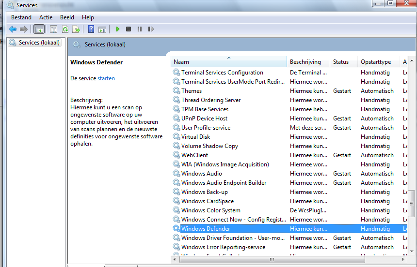

Edit :

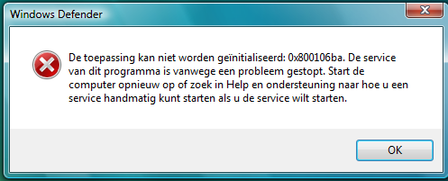

I realized that my way of shutting off Defender isn't a nice one. Better do this :
Find Defender and start it (you can use Windows Help and search for Defender). See the screenshot at the very bottom in this post. Choose the option where the arrow is, then choose "Options", and in there untick *all* the leftmost checkboxes.
IMPORTANT : When you already shut down the Service for Windows Defender, you must restart it manually first (go to Services, find Windows Defender, rightclick - Start). Now Defender can be started to give entry to the options just described.
Leave the service shut off anyway (see more above), or reboot to shut it off when you just had to start it in order to change the Defender settings.
Now the message as shown in Defender01 (below) doesn't show anymore at booting.
Also look at the last one. This says "start delayed", or IOW start when you ask for it. You might need that at times, and in normal situations ot won't run now.

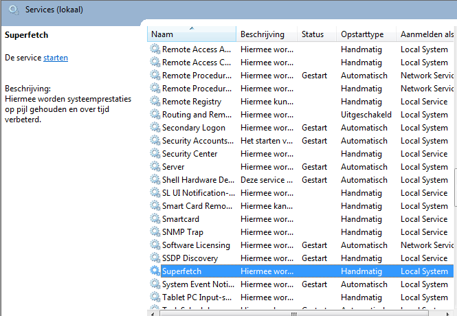

« Reply #5 on: July 22, 2008, 07:19:23 pm »

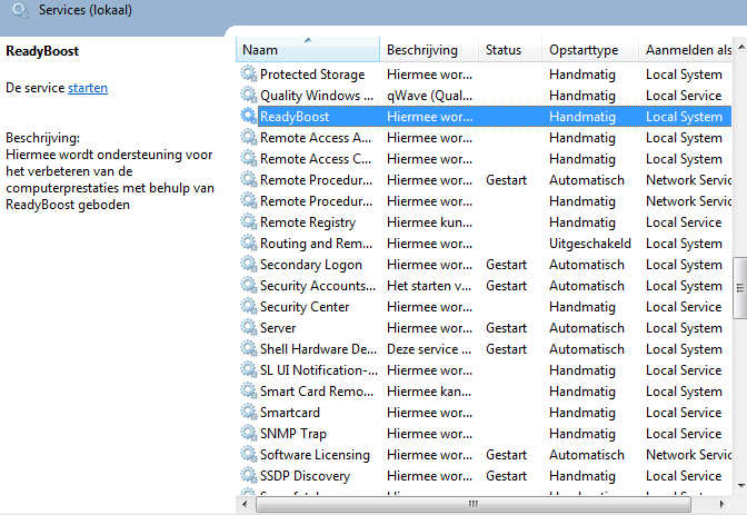

SuperFetch : Another stupid so called intelligent thing, that tries to pre-load and prepare for files to load a next time faster. One of the most I/O incurring services.
ReadyBoost : Honestly I shut this down because many people report problems with this one (and otherwise I forgot). I didn't notice any slowing down of file copying or whatever, after shutting this one down.
A special remark about Windows Search :
This one too can scan your whole disk but for other reasons than "indexing". It is related to being friendly to you;
Look at the Start Button (as you still have it). There's no room to "Run" like with XP, but typing e.g. RegEdit it will show you a link to RegEdit.exe for you to click (and run). Now, *this* will not work anymore !!
You really must shut down this service, but be prepared a bit for this now lacking help feature !

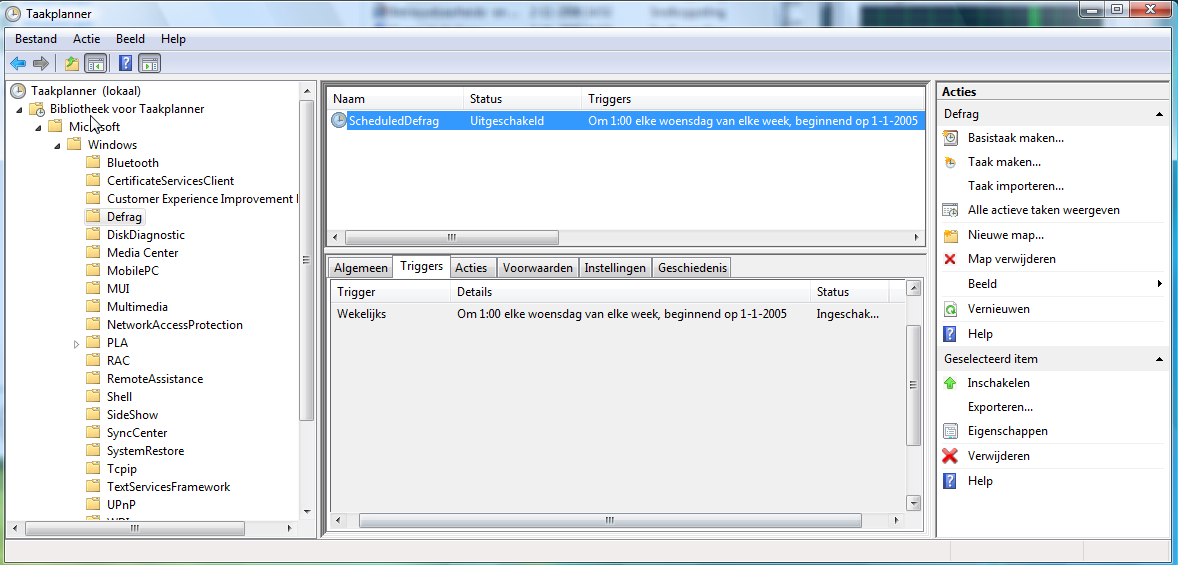

« Reply #6 on: July 22, 2008, 07:28:54 pm »
I actually didn't know it, but Windows Task Schedular controls a lot of things at preset times, many of which you wouldn't want. Below is one example I also didn't know it was happening : auto-defrag.
The first screen shows you how to get there, and the second screen shows the Status of Defrag which I shut off ("Uitgeschakeld"). Mind you, my 4 TB of disks will take a huge amount of time when they are defragged, and the shown trigger (which I did not create) may nice and easy go off each Wednesday at 1pm, but you can bet that when I want to play music somewhere in the afternoon, the bugger is still running.
Besides that defrag has always looked dangerous to me, and I'd really want it to run that one time I need it (which is completely never because I take care of the music data not being fragmented).
Note : I didn't do much further with the many many tasks which are in there, because most of them wouldn't harm me (they run a short time only, or just are performed once per year yes, etc.).

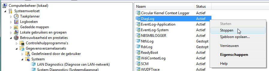

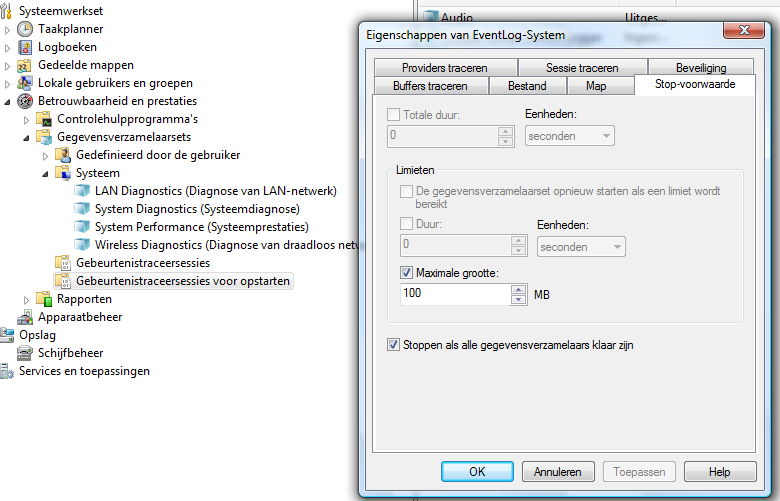

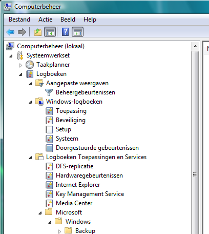

Here's the most nasty part of it all, creating I/Os which you couldn't imagine.
Note : Do not think you can shut this off by shutting off the Event Log Service, because that requires the Task Scheduler to shut down, and I won't even attempt to try *that*.
So, the first screen shows you where to go to (via rightclick MyComputer and Manage). Note you need to be at the bottom of that screen and the Windows folder shown there ("Backup" is just the first entry of the long list you see in the second screen).
The second screen shows all the logging events to shut down.
Rightclick on each of the "Operational" entries I show, and choose "shut down log" (similar).
Important : All the log files can be shut down, but I only chose the ones which may create just too many IO's. So, you could shut them down all, but a. it really isn't necessary and b. they are there for you to be informative when something is the matter.

« Reply #12 on: July 23, 2008, 11:23:28 am »

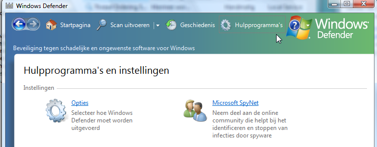

For those who already shut down the Service for defender : (as described earlier more above)
When you already shut down the Service for Windows Defender as decribed in the above, you must restart it manually first (go to Services, find Windows Defender, rightclick - Start). Now Defender can be started to give entry to the options described below.
Leave the service to start Manually anyway.
This is a new version of the not so nice solution as described in an earlier post :
Important : Obviously you must be confident in not using Defender, or beause you just are confident without, or because you have other means of spyware (etc.) protection.
Start Windows Defender (you can search in Windows Help (StartButton) for Defender which allows you to start it);
See the first picture below and choose the option where the arrow points at, followed by "Options" as shown in the left.
Now untick all leftmost checkboxes.
Next (which is merely to be sure) shut off the Service for it (set it to Manual). See the second picture below.

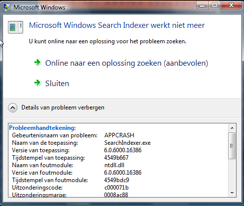

« Reply #13 on: August 02, 2008, 06:49:18 am »
Below first picture popped up two times over time during XXHighEnd playback. Hmm ... this indicated that it restarted by itself. I mean, I did shut it off (but said "start manually" (should be somewhere in this topic)).
So now I disabled it (2nd picture).
This was 4 days ago, and no anomalies regarding this appeared.
Note that if it is running again on your PC as well, you must explicitly Stop it (see the Stop button). Or reboot.
