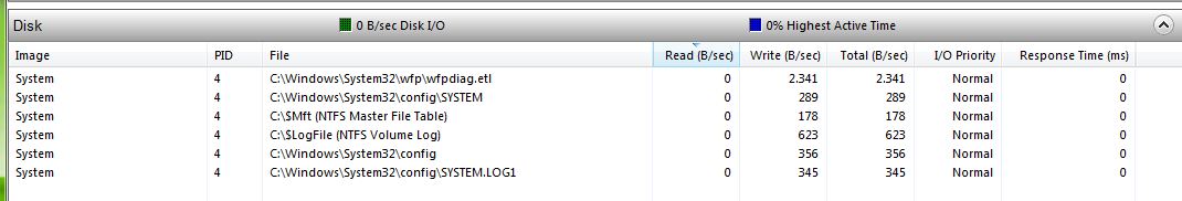

« Reply #78 on: August 22, 2009, 12:59:18 am »
there is one thing more in W7, I guess.
the .etl one
« Reply #79 on: August 22, 2009, 05:10:08 am »
http://www.vistax64.com/vista-security/68952-wfpdiag-etl-what.html
Just stop downloading. Happy
