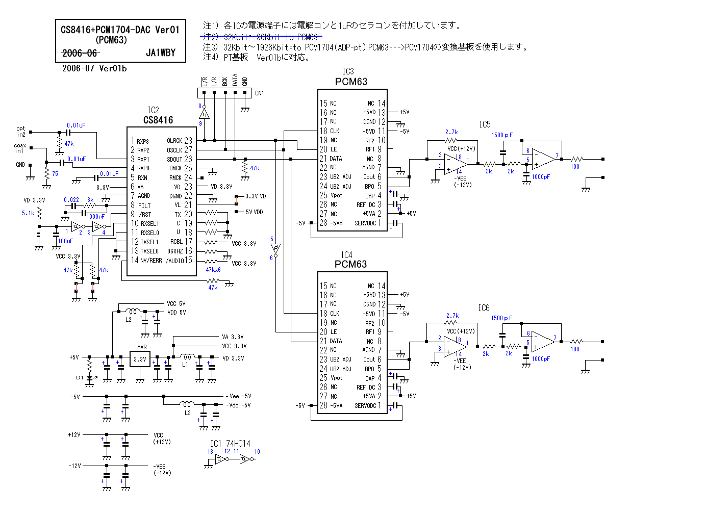

Posts: 6
« Reply #252 on: May 03, 2010, 04:08:58 pm »
Are this design able to play at 192KHz 24bit ?
There is No bit shift, no digital filter and No oversampling
The PCM63 are changed with PCM1704
« Reply #253 on: May 03, 2010, 05:48:52 pm »
Hi again Andrea,
So ... in my earlier post I said I estimated what you were up to. Now please allow me to ask you ... Happy
« Reply #254 on: May 03, 2010, 05:57:34 pm »
Hi again Andrea,
I think he wants to build a cheap 2ch NOS dac able to play highres material.
