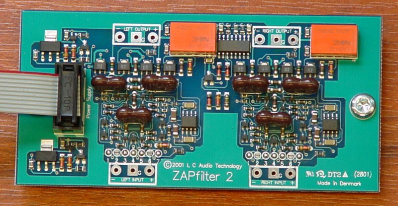

How about this one,
http://www.lcaudio.com/index.php?page=6
take analog output from DAC chips and feed in this anlog endstage the ZAP-Filter with seperate shunt-psu.

« Reply #23 on: November 11, 2009, 01:02:43 am »
I have done a great deal of testing with many opamps on many different soundcards including discretes.  I also build custom units for my testing so if you have any questions that I may be able to answer please feel free to ask.
Any of the cards with replacable opamps offer you "tunability" That other cards do not have.  You can use your favorite opamps that improve the sound quality or change it more to your liking or making the card a better match with your phones/speakers.
Welcome and join the club (of other nutcases),
Aways nice to have people around with some skills.
 Wink
