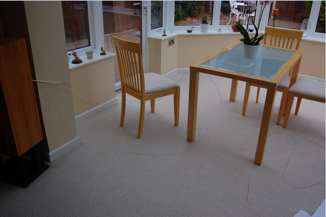

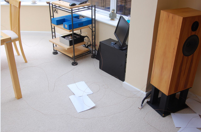

Well all I can say is that I spent a lot of time making the coax speaker cables and I was careful to make them exactly to the recipe (not twisted at all) and with the centre core of one in parallel with the shield of the other etc. I also used very good quality coax (as good as it is possible to get hold of). But the performance was just poor compared with existing 48 core litz (ptfe coated) copper cable. Very disappointing. No amount of running in would have made up that shortfall in performance methinks.
But what I am listening to now - a temporary lash up of bare copper cable festooned around the room to avoid shorting - sounds extraordinarily good. At first I thought they were close in performance to the 48 strand litz ptfe coated cables but after a very short time it became clear that they are much much better. And that is a very big surprise - I was simply looking for something that would be just good enough to drive the base units in the coming bi-amp set up that would be cheap (cheap is important to me at this time!!). But simple bare wires are much better - really special. It does seem that the lack of wire coating (dielectric) (PTFE in this case) makes a huge difference. So how important is skin effect? - single copper wires should suffer from skin effect to some degree (as opposed to Litz wire which should not suffer skin effect) - Either that or the gainclone amp likes the electrical characteristics of the simple bare wire rather the the 48core litz cable but I am not sure about that.
The problem is that my conservatory now has bare copper wire festooned all over the place and my wife cannot get in - she is not happy - not happy at all (even though she likes the sound of the cables  unhappy   -  she has only just recently stopped mentioning the colour of NOS1 so I have to be careful - very careful.
But I have a cunning plan !! just hope it works - watch this space  Happy
« Reply #35 on: July 10, 2011, 06:27:08 am »
Put them in a large rain pipe ? hahaha
You don't happen to have a picture of this high current danger ?
But that dielectric ... yes ...
« Reply #36 on: July 10, 2011, 12:01:26 pm »
Ha Ha Ha  - how did you know that 3 years ago when we made big changes to our house I ran a 6" drain pipe under the floor buried under the concrete just to take speaker cables. Of course then I did not know that it would be for skinny cables with no insulation I thought it would be for big butch insulated cables - I did not know then what I know now  Happy (wish I had).
Pictures attached the wires are only 1.5mm2 so hope you can see then - big enough to trip up any unsuspecting intruder though. Not sure if the strategically placed pieces of "insulating" paper act as a dielectric though ha ha.

« Reply #37 on: July 10, 2011, 12:21:57 pm »
LOL
Are you sure there are no shortcuts anywhere ?
Yes, I did the same, though with 1" pipes. All carefully planned. Until I wanted to use them in practice and all of them were too steeply bended in the floor somehow, and nothing will go through them. Well, sh*t happens.

@Scroobius
Is that an experiment cabling? It looks so funny Happy

Hi Gerard and Flecko,
Yes the wire is experimental but also doubles as a trip wire for burglars  Happy.   My existing wire is 48 strand litz (PTFE insulated) so no resistance problems (4.17mm2 equivalent per conductor). The surprising thing is that with 2 x 1.5mm2 (so 3mm total per conductor) everything has improved. The most surprising is the base which is significantly better controlled.
