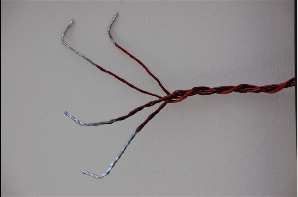

Since there's talk about the anti cables, I'm not sure anymore whether this actually *is* about anti cables. I mean, like the ones I talked about myself (but sure you made them from different material). So, are they ?

I just used plain old "as drawn" copper wire with a lacquer coating as found in transformers and coils. So called "anti cables" are the same but use soft annealed copper (i.e. amorphous crystal structure). But anti cables only come in one diameter whereas mine (thanks to Gerard) comprise many strands which (if it is important - at my age I probably don't hear much above 8-10kHz anyway) should keep impedance down at higher frequencies (due to skin effect) - well who knows but that's the theory. All I really know is  WHO CARES it sounds great ha ha ha.

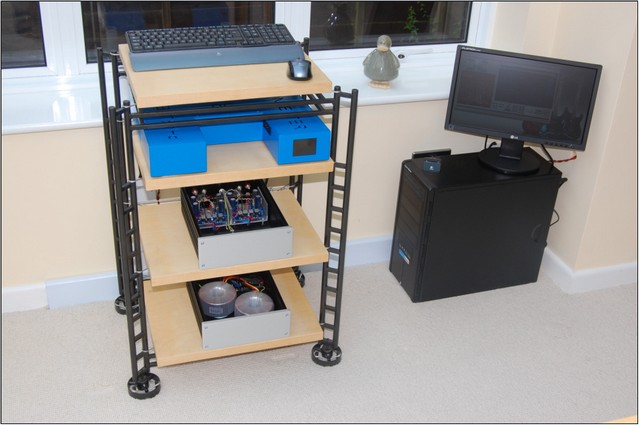

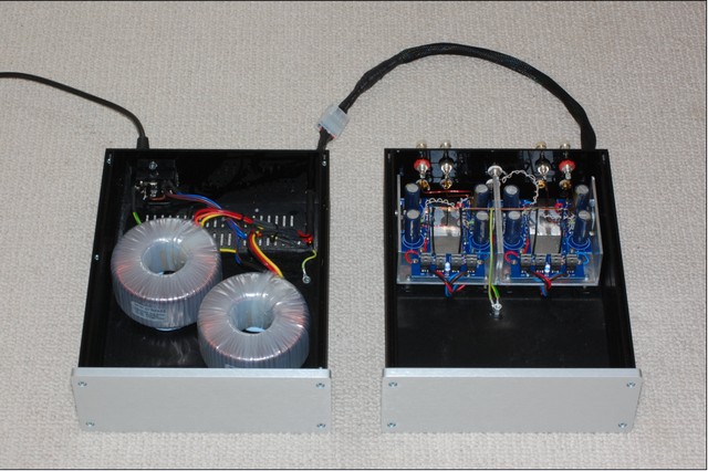

Hi All
For anyone interested here are some pictures. All this was a lot of hard work and if I had known then what I know now it would be much less work for sure. But the end result is just superb sound quality and I would strongly recommend anyone thinking of building a GC to go for bi amping at least - it wont cost much more and the improvement in sound quality (as Nick pointed out) is substantial. The components and circuit boards I got from AudioSector and links to that site are given above. If anyone does want to build a GC I would be pleased to provide some details of what I did hopefully it could save them some time. Also I could provide a few tips on twisting the speaker wire (oh boy what a pain that job is!!).

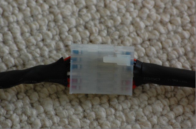

Does anyone recognise the plug/socket in the wire harness from the power supply to the amp? it was a 20 way power extension cable out of a PC that I cut down to 12 way - that worked well I could not find a suitable plug / socket anywhere also in line in the cable meant no cut out in the panel required.  Happy
And yes you have seen that speaker cable before it is in Gerards post above somewhere. At the end of all of this I am still astounded by just how good this speaker cable sounds a huge difference.
A huge thanks to Nick (for this thread) and Peter (for this forum) these babies would not exist without them. The beers waiting chaps!!!!.
Now where was I? oh yes I have some music to listen to he he.
