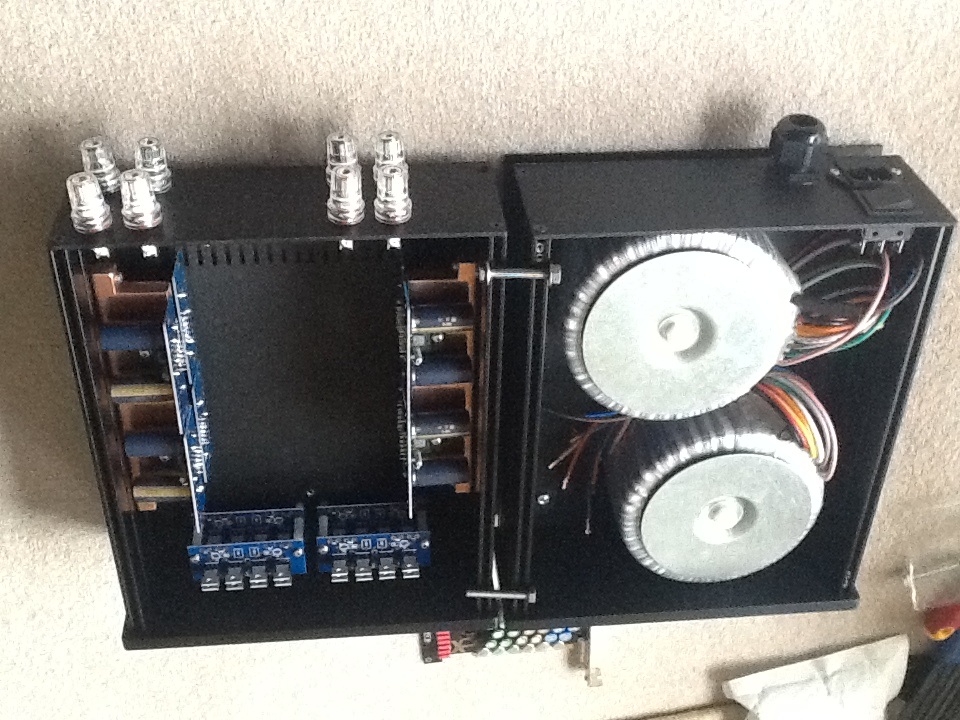

« Reply #249 on: April 11, 2013, 07:56:31 pm »
I finally got around to starting a gainclone MK II build and thought I'd post some pics of the build so far.
As you can see the modules and rectifiers are built (sourced from Peter Daniel) and I'm close to completing the case fit out. Next stage is wiring up then testing.
The final result will have balanced inputs and bridged and bi amped outputs, so it used 8 gainclone modules in all driving 4 output channels with each output having a pair of bridged modules. It's dual mono back as far as the mains input lead.
Really looking forwards to seeing how it all sounds.

« Reply #250 on: April 12, 2013, 11:46:36 pm »
Hey Nick - Looking great so far - those lumps of copper (?) look good!!  Balanced amps should be better from a noise point of view. When finished maybe you could bring them here and we could have another session.
I have spare 4 amp modules so I have all the parts (also the same amp cases) to build a balanced myself. Perhaps you could bring them here when you are finished and we could compare balanced versus the stock version?
P
« Reply #251 on: April 13, 2013, 12:45:25 am »
Interesting pci card on the top picture!
How is the power going to enter the amplifier module? Theresoes not seem to be a lot of space left on the "backpanel"?
Nice wrk btw!
Regards, Coen
« Reply #252 on: April 13, 2013, 11:33:42 am »
Hey Nick, nice !!
Maybe a possibly important tip for you :
We already know about the necessary matching for DC offset between the chips. Well, I think that when setup differentially this is even more important. Besides that, equality of the level (output) of both plus and minus will also be crucial. So :
Either DC Offset which is not the same, or the output level which is not the same, will create anomalies which may let fail everything. Not only you'd have distortion but also the noise cancellation will act strange (when both signals are not exactly equal).
When you can get it done, the improvement should be vast. At least it is totally easily measurable, so it should be audible just the same.
Jaleous Peter
PS: Do I see 8 secundaries in total in there ?
« Reply #253 on: April 13, 2013, 12:08:20 pm »
Thanks for the encouragement and the advise on offsets. I had been giving them some thought it looks like i have to setup a test harness to power up each module measure offsets and match pairs of modules.
Yes there are 8 seconderies overall, I was keen on having each output electricly a monoblock as far back as the transformer iron. The ratio of two modules to a supply seems to work very well so to keep to this and limit the transformer count to 2 I had these custom wound with four secondaries. They are 625va which keeps the ratio of 300 va for each pair of modules.
Of course this is just a load of theory until i can take a listen dntknw
« Reply #254 on: April 13, 2013, 12:13:36 pm »
P
Paul,
Im definathy up for a visit when the amp is finished. It would be great to try it though your system, provided it dosen't sound awful, there are a lot of assumptions in the design right now Happy
