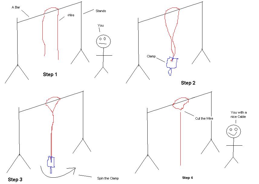

« Reply #86 on: August 30, 2011, 04:50:34 pm »
Also I could provide a few tips on twisting the speaker wire (oh boy what a pain that job is!!).
There is a trick how you can do it nice and easy. I draw a scetch to show it to you.
Sorry for the bad picture quality. I saved it in some horrible jpg.
Fleko,
I have used this approach a well, at least with insulated wire. My addition would be to replace the clamp with the chuck of an electric screw driver to do the winding. I wonder if this might work with enameled wire without damaging the insulation ?
Ps like the diagram a lot  Happy

« Reply #89 on: August 30, 2011, 05:11:05 pm »
I think the clamp works better, if you use a very big and heavy one. It has to hang free in the air. Due to its weight you just have to give it a nice spin and the cable twists itself! You will have a very homogeneously twisted wire because of the constant gravity force that the weight of the clamp deliveres.
