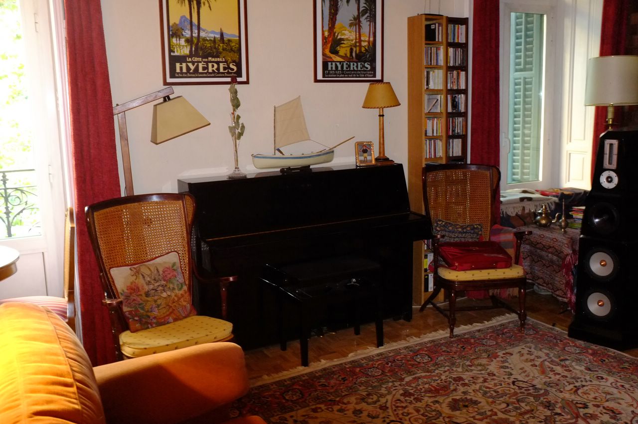

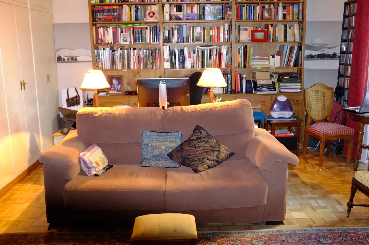

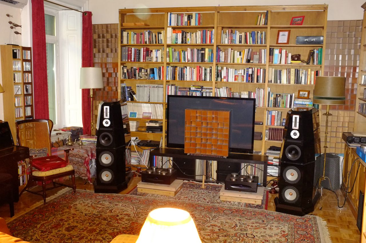

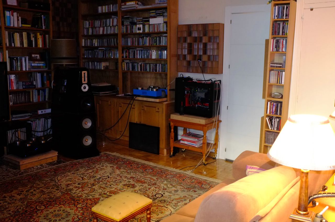

Brian, about the room treatment, the best non technical and more practical treatment is to put some shelves with plenty of books on the walls, the front and rear wall can be similar but just try to put something different in the left than in the right wall.
As you can see I use those Ikea thick boards under the amps, dac and computer. When I use two of them like under the amps and also under the NOS1 I use some mouse pads to stop the vibrations. Not high tech but it works very well.
My room is (L.W.H) 7 x 4,95 x 3,03 mts. A little narrower in the rear wall.
