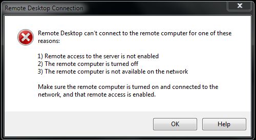

Hi all, I'm kind of reluctant to post this here, because it really doesn't have anything to do with XX, but I'm trying to get RDC working via bluetooth and am having problems.
The two computers see each other no problem. But RDC refuses to work. I will go online and do some research myself, but if anyone has an obvious fix, please let me know.
Cheers, Mani.

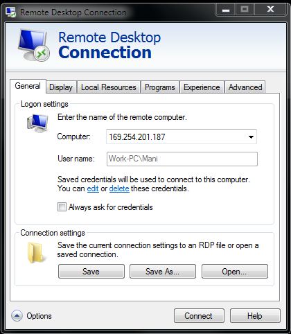

« Reply #2 on: August 22, 2012, 11:32:46 pm »
NOT ALL SORTED!
I'm having problems connecting with the computer name '169.254.108.156'.
When I thought everything worked OK, I was connecting using the name of the AudioPC (MAIN-HIFI-PC in my case) and not '169.254.108.156'.
Connecting via the name of the AudioPC works fine if the AudioPC is not in Minimize OS mode. But as soon as you go into this, the connecting PC cannot find AudioPC.
I cannot connect using the name '169.254.108.156' irrespective of whether the AudioPC is in Minimized or normal OS mode.
Any thoughts?

« Reply #5 on: August 23, 2012, 07:56:51 am »
Hi Stefan - Peters IP address did not work for me either. I used the actual ip address of my PC which is different to Peters. Mine works with the LAN services off so don't know what to suggest there.
« Reply #6 on: August 23, 2012, 09:38:42 am »
ALL SOLVED!
If you have problems establishing an RDC connection when the AudioPC is in 'Minimize OS' mode, then you need to connect using the AudioPC's IP address. To find this:
- make sure bluetooth PAN has been established (see tutorial)
- run the command line (cmd) in AudioPC
- type 'ipconfig'
This will give you the IP address of the bluetooth connection. In the connecting PC (laptop, or whatever else you're using), use this address in the RDC window, and NOT the one Peter states in the tutorial OR the name of the AudioPC (this will work, but not if LAN services are off). I attached a screen shot of mine, but of course your IP address is likely to be different.
HTH.

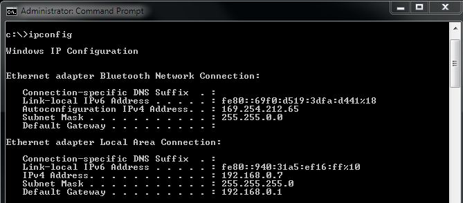

« Reply #9 on: August 23, 2012, 11:26:34 am »
Here's what I get...
PS. But note that this is for the BT-PC not the Audio-PC (the latter is not connected to a LAN and it's too much hassle to transfer a screenshot).
« Reply #10 on: August 23, 2012, 11:50:15 am »
I used the "Autoconfig IPv4" address and it works fine

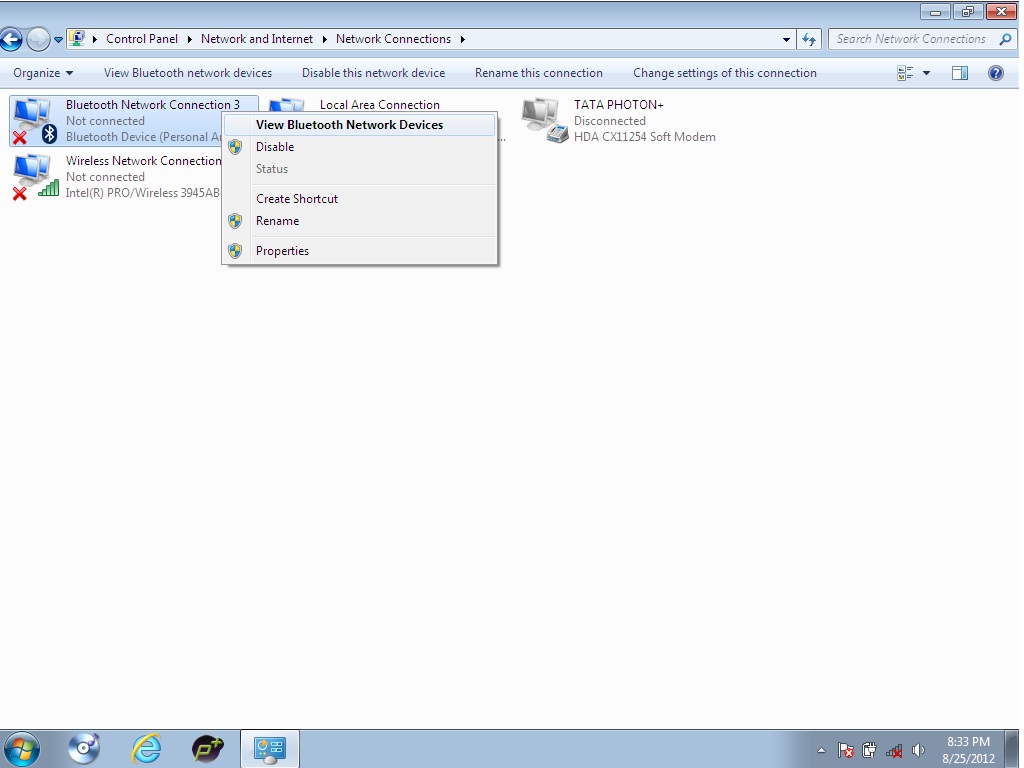

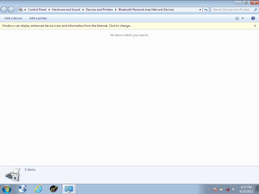

« Reply #13 on: August 25, 2012, 05:18:51 pm »
Attached are 2 screenshots from the Laptop.
Identical pictures from the audio PC too.
Hope these help.
« Reply #14 on: August 25, 2012, 05:37:09 pm »
Arvind, I am sorry but you now showed the status of how you have it. Can you answer my previous questions please ? Thanks.
