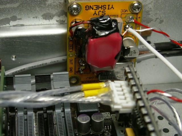

Please note also Peter that Paul Pang recommends 5V 1A minimum external power for the card which is 900mA to meet the power output of the USB3 specification (that is never used in our situation as far as I can tell) plus 100mA to run the card itself.  When I measured the power draw of this card in the Linear PSU thread it never drew more than 20mA when it was connected to the NOS1.  You could use a super low noise/low power psu for this card.
Also, Paul also upgrades motherboard clocks with what seems to be the same clocks as used on his USB card (see picture below) and he also has a modded CF card reader that can be used as the O/S disk instead of a SSD or HDD.
All food for thought if we are thinking about the clocks in general.
