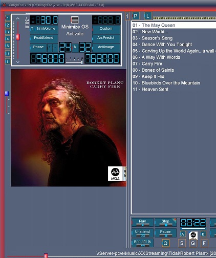

I'm afraid you have a decoding issue. See below for how it is supposed to look and mind the "96" icon in the bottom right corner. If you see nothing of this anywhere in your Library Area then on that PC the decoding does not work.
Btw, I take it that you use 2.09 for this (the Tidal-approaching PC !) ? because that *is* required ...

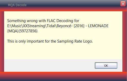

I think I've found the issue:
It seems to be a base rate problem (44.1 vs 48). MQA 44.1 rates work fine (see below), however 48 rates don't. The issue seems to stem from my music server. I get the error shown below when preparing streams.
Well, that nicely testifies of what I was saying.
I don't think anything works fine because any "96" album should show 96 for base rate and not 48.
Your decoding just does not work and it *has* to work already on the PC where you Prepare things, or otherwise nothing works.
I don't see you responding to my 2.09 remark, so I take it that you don't use that on the "Tidal" PC. Haha.

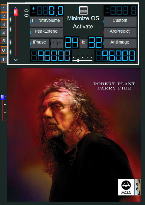

I upgraded to 2.09 on the music server ('Tidal' PC) before trying anything.
I deleted and re-prepared the MQA albums. Everything works fine. Thanks.
