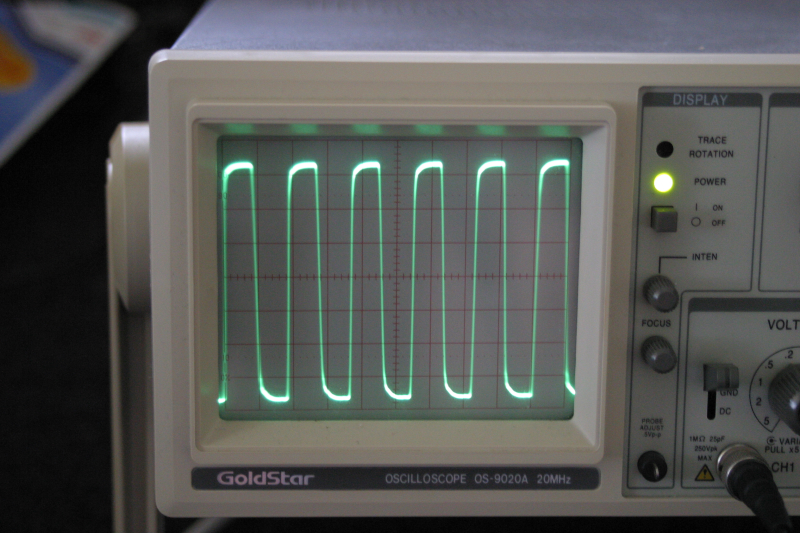

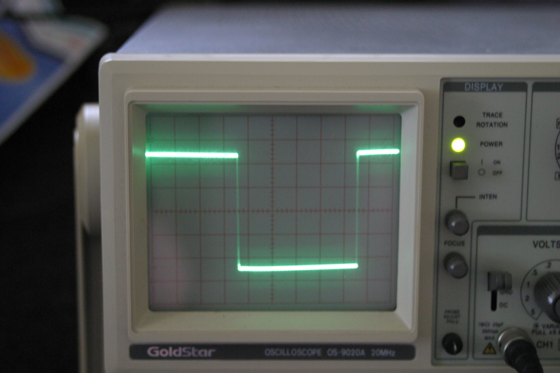

Well, the decisions taken and all, the now definitely to use interface I had laying around for two months already, today was soldered next to the DAC. The I2S lines are still 18cm (1cm to be) and the below looks pretty good to me.
Firewire is clocking, buffers set to 1ms (can be less), I'm listening to Taj Mahal - The Real Thing, and I have the shivers for more than 50 minutes now (who needs Viagra grazy).
A tuba already was an instrument I recognized as a very good representative for sounding honest and real - or just not, but man, this really beats everything and all. Phew, the album just finished minutes ago, and the shivers won't go away.
And then imagine it was the last album I played yesterday, sounding awfully good already (you just can't sit still on that last 19 minute track), but shivers ? no, not that I was aware of.
Or maybe it's because I at last got where I wanted to be for so long (and theories start to work out) ?
