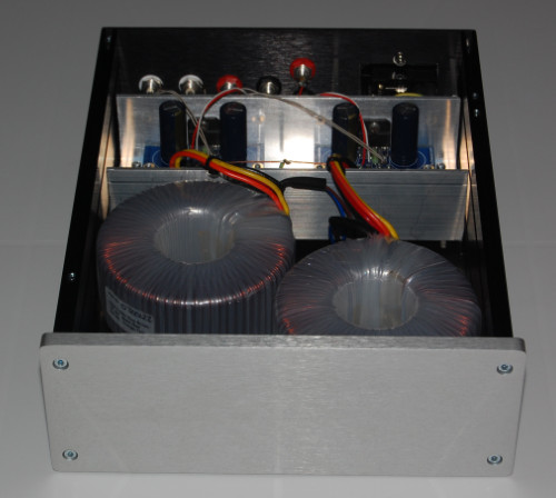

Per - Yes audiosector is the site. Here are a couple of pictures of the GC so far. Its not quite complete I just need to tidy and final run of the I/O wiring before bolting down the lid.
Nick - I did not install the input resistor just a bypass link after reading comments on the diyaudio site. Gain is high (separate issue to input R) I have just been listening (at quite a reasonable volume) at -30db but with the 300B's I was never much below -6 / -9db. I do not have volume pot on these as prefer to use XX digital volume I may reduce the gain at some stage by changing the feedback resistor(s) ratio but no rush to do that yet it sounds fine. I can get some serious window rattling volume now which I have to say is v welcome (sometimes when the neighbours are all out :-)
I agree exactly with your comments about the sound quality of the GC's what an audio bargain they are!!.
Also I spent a great deal of money upgrading my AN monoblock 300B's I could have saved a lot of time and money had I known then what I learned from this thread. One of the things I love about NOS1 and this forum is that after selling all my old kit I will have more money in the bank (quite a bit more) and a hugely better sounding system. I never imagined my system could possibly sound this good and there are more changes to make  Happy
Can't wait to hear the mods to NOS1 - improved sound quality? mouthwatering.
By the way note that the transformers below are secured in the same way as NOS1 - good old blue tack.
I guess one of the reasons the GC's sound so good compared with the 300B's is the GC lack of an output transformer - Mani is coming to see me later in the summer with his output transformer less 300B amplifier - that is going to be a very interesting session and I will report back with our findings.
Regards

Thanks a lot, Paul for the pics. Nice job  Happy Where did you buy the case and the trafos? Best, Per
Sep 2010
« Reply #26 on: June 16, 2011, 01:19:24 pm »
Hi Per
Trafo's from Airlink    http://www.airlinktransformers.com/    in the UK - good quality units. I found it difficult to find decent looking cases there are quite a few out there but most of them look home made I eventually found these  http://www.modu.it/homeeng.html  which are based in Italy. The cases are v good quality and look nice with lots of sizes to choose from. Nice company to deal with as well. Only problem is that whilst the cases are reasonable price courier charges are quite high but anyway they arrived very quickly so OK. Modu will also engrave and ink the front panels if you really wanted to go that far. If you want any more info please let me know.
All the best
