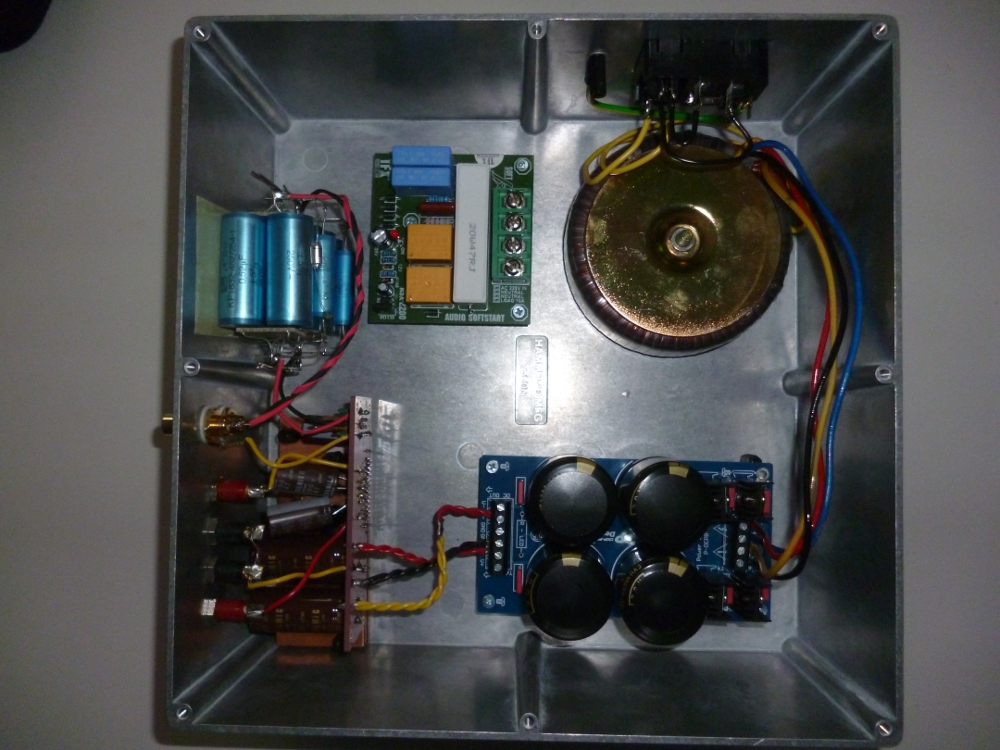

Here is the actual result of my last weeks effort. The system is build up on commercially available pcbs, assembled and wired as written in my first post.
Nothing special but I tried to get analog in and analog out as near as possible. Therefore the copper rails and the chip are mounted at the bottom of the cabinet.
The pcb at the left side of the transformer is a softstart unit which is not necessary at this time and unused.
Because I'm using very rare Philips Alnico drivers there is no chance to do without a coupling capacitor. I tried a lot (had two well broken in black gates for lease from a friend, which showed the direction) and ended up with a satisfying solution: A (new old stock ) combination of Roederstein KP1832 and NSF Styroflex capacitors.
Georg

« Reply #298 on: June 02, 2013, 09:57:15 pm »
Georg hi,
The build looks great ! And an interesting story about the input caps, defiantly best to be safe there  you certainly don't want any accidents with your drivers.
How is the sound ?
Best,
listening
Posts: 199
« Reply #299 on: June 02, 2013, 11:02:18 pm »
Hi Nick,
that was he biggest challenge and hopefully I have not to repeat the process too often Wink. After trying oil caps, mica, foil, even vacuum caps and other nice stuff I ended up always with a sonic compromise. Some types work best for rock and jazz others better for classical music. The actual combination is suitable for the long term, works with all types of music and has a delicate and colorfull character.
Georg
