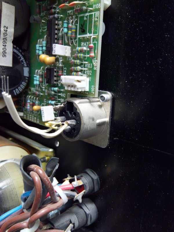

I´ve found that the XLR in my speakers have a capacitor, is there some problem if I remove it to solder the wires as you told me to place there the BNC connector?
« Reply #428 on: December 10, 2014, 12:48:13 pm »
Hey Juan,
If I see it correctly, that capacitor is soldered on the ground pin (of the three of the XLR terminal I mean). You can measure (Ohm) whether the terminal itself is connected to the chassis. So I mean : whether the metal of the terminal where the cap is soldered to, is connected to the chassis. That assumed :
Solder the cap to the ground of the BNC terminal (the lip on the side) and connect the other end of the cap to the chassis somewhere (extend it a little with a wire).
Clear ?
« Reply #429 on: December 10, 2014, 12:51:40 pm »
Thanks Peter, l pass the information to the technician.
