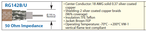

Me not so happy me thinks ... swoon
Robert, you must be correct with the RG142. Maybe no wonder why I couldn't find any better than the one from L-Com. But are we hoaxed ?
Below two screenshots - one of the cable (spool) itself as they sell it and one of the assembled cable. With the first we might think that there's no space for the "steel" word. But the second shows it can't be an accident. Together with the page from Brian and mine (yesterday) there's now 4 pages of them showing this.
And yes, as far as I can see RG142B/U is officially steel.
grr
PS: I showed the first screenshot as done in order to show that L-Com sure is "capable" of telling about (clad) steel.

Here is data sheet from RS
Data Sheet RS Stock No. 521-5386
Cable Coax RG142 FEP brown 25m
Cross Section:
Description:
Rated Temperature (o
C): -70 ~ 200
Rated Voltage (V):
Product Standard Certification:
Flammability Test:
Construction:
Conductor: Silver Plated Copper Clad Steel
Conductor Dia. (mm): 0.94±0.02
Insulation: PTFE
Insulation Dia. (mm): 3.0±0.1
Braid Shield 1: Silver Plated Copper
Conductor Dia. (mm): 0.12
Conductor Qty: 16x7
Coverage: >90%
Braid Shield 2: Silver Plated Copper
Conductor Qty: 16x7
Pitch(mm):
Coverage: >88%
Jacket: FEP
Outer Dia. (mm): 5.0±0.15
Colour:
The color of the insulation: Nature
The jacket color: Brown
Marking(3times/m):
RS 5215386 Cable Coax RG142 FEP brown
Performance:
Electrical Characteristics:
Frequency Attenuation(dB/100M)
700MHz 35.1
900MHz 40.4
1000MHz 43.0
2000MHz 63.3
Specified value (max.) is not more than 108% of the nominal
value
Character Impedance: 50 ohm
Capacitance: 95.1pF/M
Velocity ratio(%) : 70%
Check this page:  http://nz.rs-online.com/web/p/coaxial-cable/5215386/
